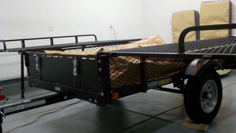

Mostly assembled...

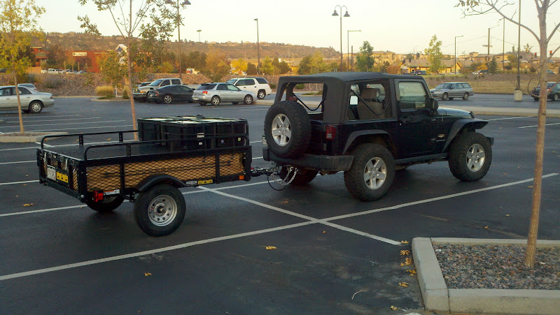

And... finished. Now to take it out and initiate it! I think we can steal away this weekend for a quick overnight.
The nice thing is we can load an ATV on the top. Right now I just have some plastic tubs strapped to the top.
I guess that's going to be the next "mod"...

what trailer is that?
edit: nevermind... found it... jumping jack by lifetime trailers...
sheesh... kinda pricey lol... too rich for my blood
Close... it's the smaller Lifetime Tent Trailer. The jumping jacks are about a foot wider and a foot longer.

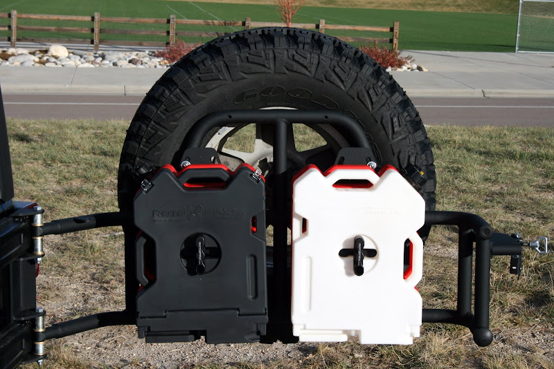

Been awhile since I updated this. I have:
1) Added Rubi sway bar with a manual disconnect (god bless craigslist!)
2) Went to 35x12.50/17 Wrangler MT/Rs (Kevlars). The 305's were getting a bit short on tread depth. This required upper and lower adjustable control arms in the rear to stretch the wheelbase by 1". That centered the axle in the wheel well on full compression. I also did a whole lot of pinch seam and rubi rail trimming, and ditched the rear bumper.
3) After ditching the rear bumper, I went with the Evo D-Ring Mounts
4) I originally just went with an extension bracket for the tire carrier, but the rattling tailgate was killing me. It was especially noticable with the hard top on. So, I stepped up to an Or-Fab Jerry Can Tire Carrier. I got the regular full Jerry Can version, and then ordered the optional Rotopax Mounting Plates (thanks BigRedJK for the info on how to do it! https://www.jk-forum.com/forums/modi...4/#post3180015). This lets me carry up to four 2-Gallon Rotopax containers, and by simply removing two bolts I can go right back to the regular Jerry Cans and carry 10 Gallons of fuel if I am doing an extended trip.
Even with the Locking Handles and the mount extensions, I still have quite a bit of clearance between the tail gate and the handle tops (those stick out the furtherest)
I am still at Zero Lift
I still need to sort out some clearancing issues... Relocate Rear Track Bar Frame Mount and relocate the rear sway bar. To relo the sway bar, I need to relocate the muffler, and to do that I need to relocate the Evap Canister. So next weekend should be busy.
Here are a couple more glamour shots:
I just got notified that the Artec Trusses have shipped this week for Rubi 44 Front/ Non-Rubi 44 rear. Axle build up is next!
