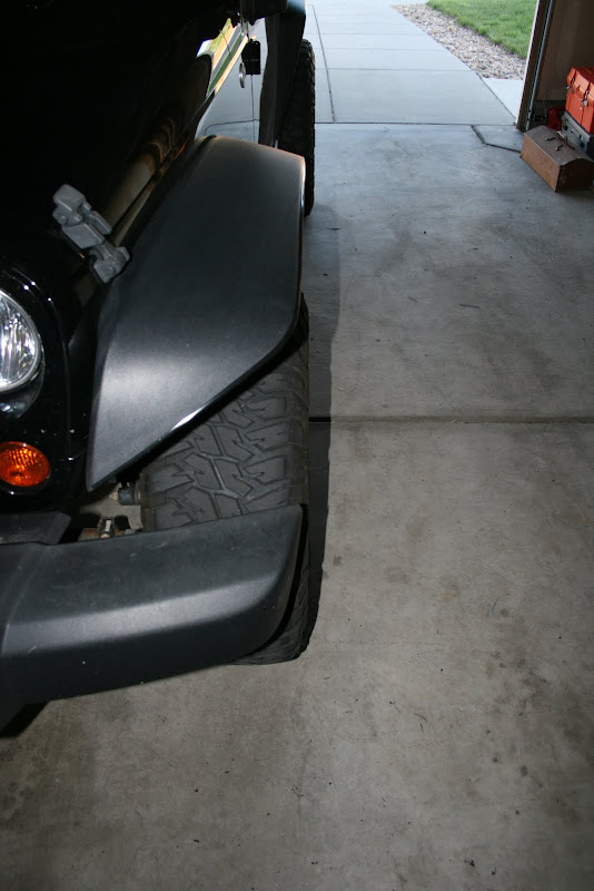

Found Red's Fender Trim thread, so I picked up a set of stock fenders to cut...
Taping up the cut lines:
After putting them on, with stock tires and step:

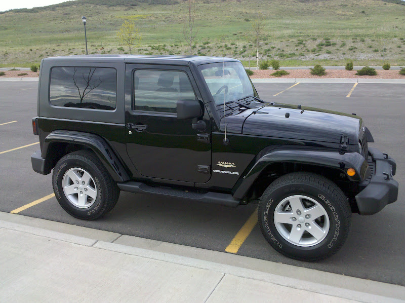

So here are some show-off pics of my current setup:
Lift: None
Tires: 305/70/17 Goodyear MTRs - Pre-Kevlar version
Wheels: Stock 17" 5 spoke w/ Spidertrax 1.5" Spacers
Fenders: Red's Fender Trim
Rails: Rubi Take-offs

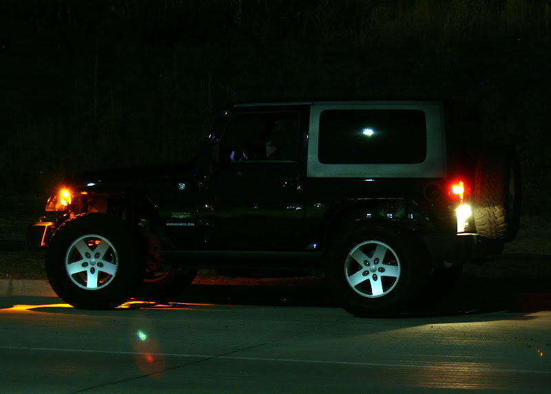

When you do the fender trim, you lose your side marker light. Here is my $5 Wal-Mart solution...
Some work with the Dremel and a little black RTV to hold it in place, and I am using my stock wiring harness at stock length.
I placed it so it can be seen from the side, but not from the front. Yet it will throw the majority of it's light downward.
Side view:
3/4 Front View:
Light on the ground... when I trim my bumper, there will be a lot more:

Aggressive Fender Trim = Lots of mud!
