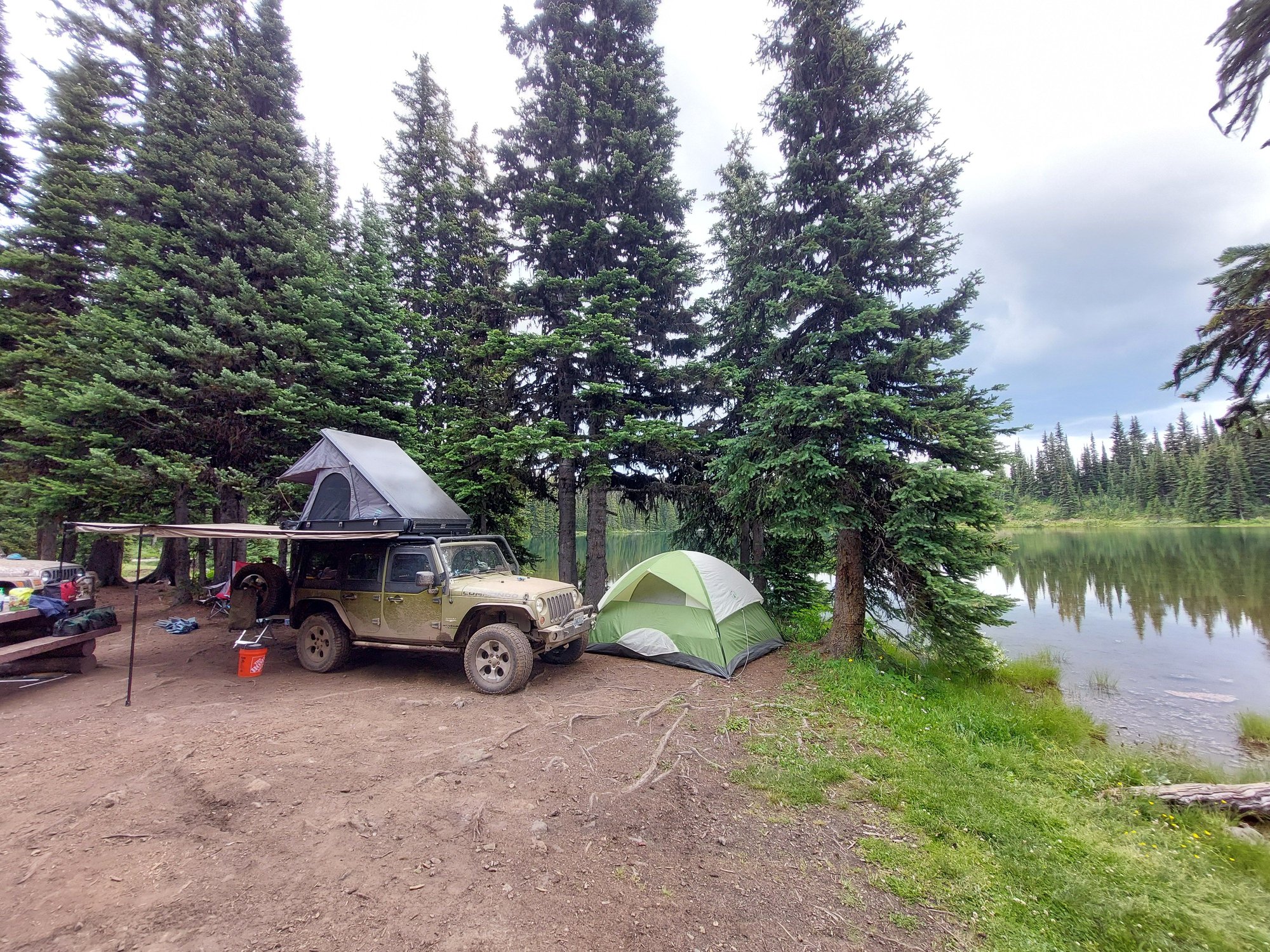

I have an OVS Mamba Roof Top Tent, which has proven to be quite good. I've had this tent for about 3 years now, probably spent 30+/- nights in it. It's large enough to be comfortable for two adults. The mattress left a bit to be desired, so I added an additional 2" foam mattress, as well as an air mattress. My wife is a side sleeper, so this was a must for comfort. This past summer, I added a Rhino Rack Batwing 270 degree awning, which has helped a lot to keep us out of the sun in the summer, and I've made a couple wet trips with it as well for rain protection. This was from this past summer on the Whipsaw trail up in BC

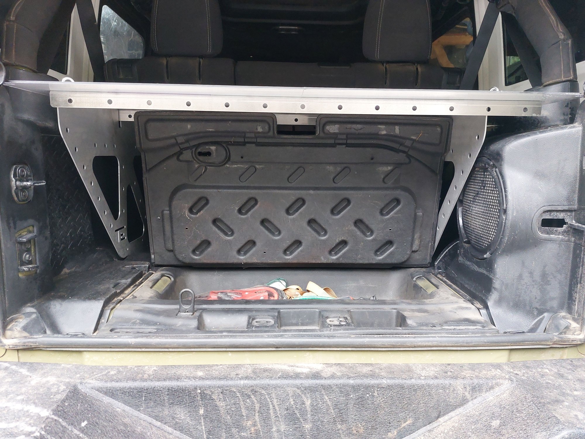

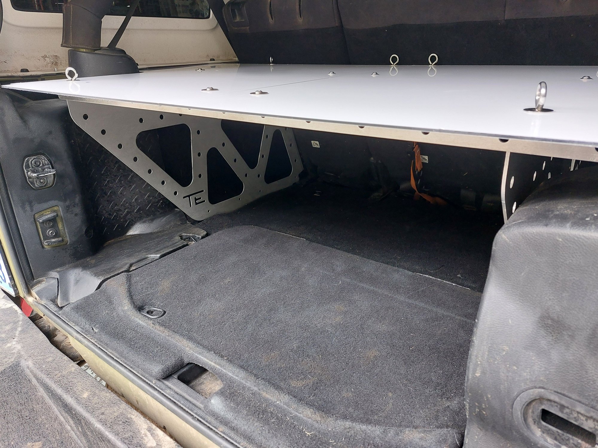

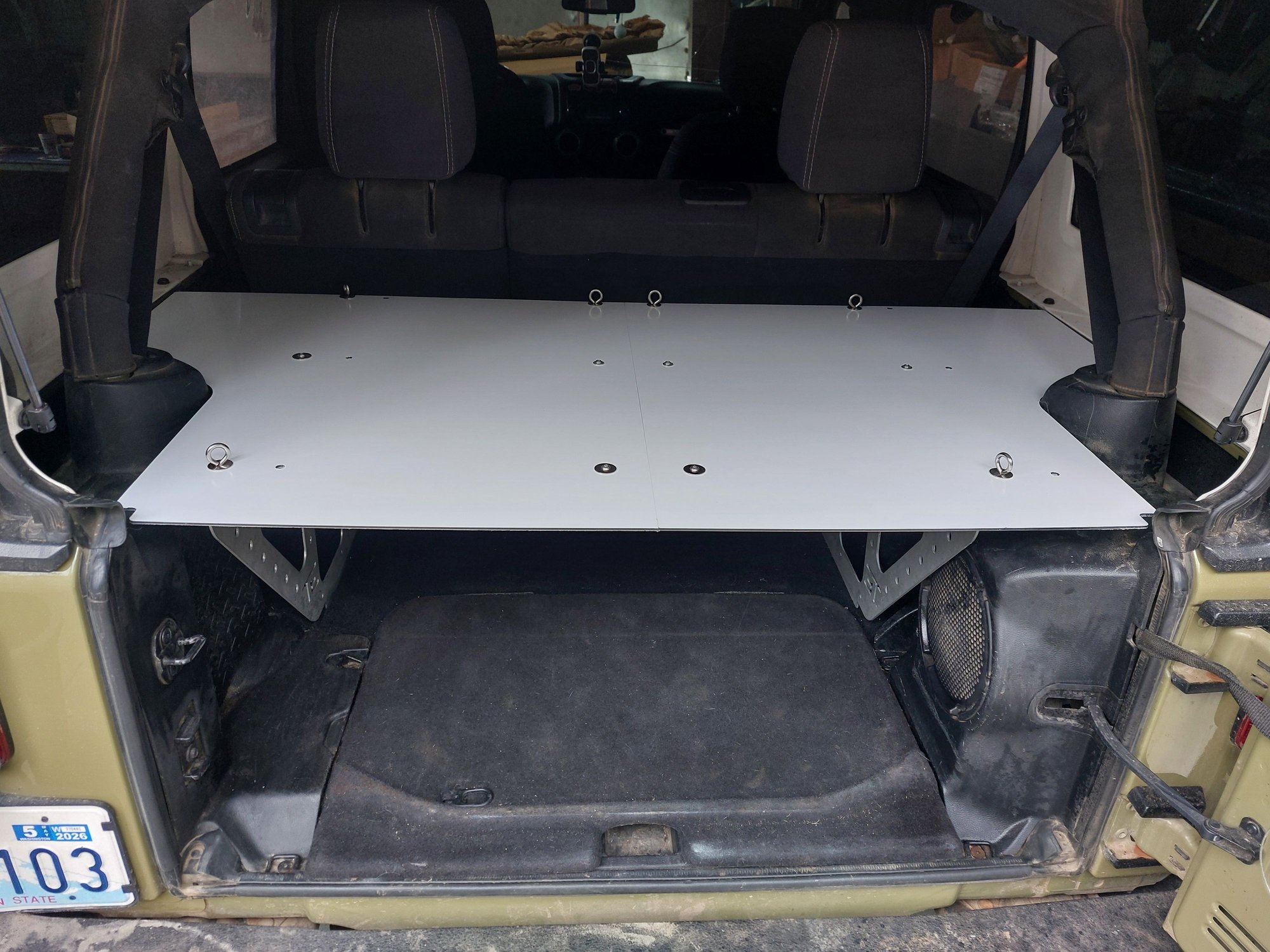

I struggled finding a good solution to store my gear and keep it organized in the back of the Jeep, so I designed my own out of CNC cut and bent aluminum. I really didn't want to block the factor JKU rear storage.

That looks Great, I'm defiantly impressed, would you have a copy of the parasolid .x_t x_b or .dxf files you'd be willing to share ?
I was a machinist/programmer 41 years and the company moved the CNCs and stuck me in quality but have a friend with a large CNC mill and Laser
and would defiantly like to do something like that before Moab trip in March
is the top plate a sandwich with composite center ?
Again that is nice
