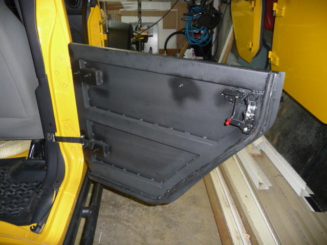

Default Finally done (kinda...)
The Krylon doesn't match worth a shat so I am going to have them painted this winter when I get the front doos done. I just got the skins done and hope to make the frames this week.

Default picture trouble :(
I think these will work...
I'm starting on the fronts this week!
