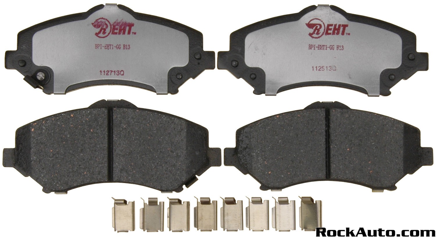

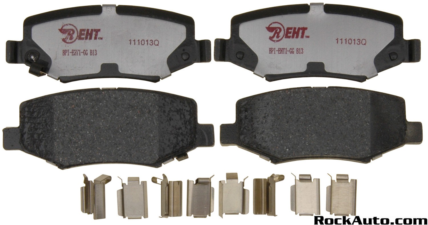

Installed the new Raybestos ceramic-metallic hybrid brake pads (EHT1273H & EHT1274H) about 500 miles ago. The DOT friction code rating is GG for all pads, factory is FF -- A higher coefficient of friction should translate into more braking force for the same pedal effort. The shims on the back of the pads are thin steel bonded to resilient material that's bonded to the back of the pad.
Can't quantitatively say how much better the braking might be, but it feels like an improvement.

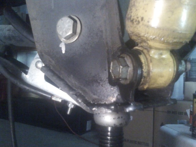

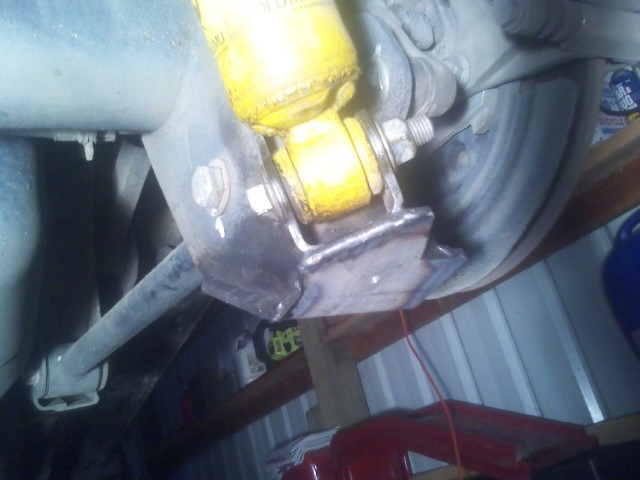

Name:	Rear LCA Skid_Welding_1.jpg
Name:	Rear LCA Skid_Welding_2.jpg
Name:	Rear LCA Skid_Welding_3.jpg
These skids are made by PureJeep (PJ5153), and are 3/16 thick. The end result after some grinding prep (angling where the skid meets the shock mount) is a flat-bottom skid that is only a little more than 1/16" lower than the stock shock mount, which is the factory low point.
Compared to other skids, it's a minimalist concept. It adds very little that could end up being a rock-magnet.
Except for the rear of the shock mount, it's all fillet welds. Nothing was removed before welding. One drain hole was drilled in the bottom. Access was a little tight using just jack stands and welding while laying down, but not too bad even for a quasi old-guy like me.
Side Note: 285 wide tires with stock wheels and no spacers affords some protection for the LCA mount, the outboard half in particular. Before welding, there were a couple dings on the inboard side to clean up, the outboard side was like new.

Those shock skids are something that should have come factory. I did the rear shock relocation on mine so welded up my own skids back there after cutting off a couple inches. It's amazing how much nicer it is running through rocky patches without those damn mounts catching every.single.rock.
I like that yours make use of the factory mounts but mine were too mangled to even try and save.
Keep it up!

Thanks, good post -- Keeping re-location as a backup plan. From memory, the shocks I'm using actually have a shorter compressed length than stock (and a 1" longer extended length). Jeep really should have raised that shock mount a bit...
