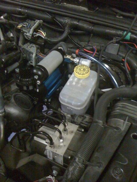

Finally had some time to install My NEW ARB Underhood Compressor
ARB High Output On-Board Air Compressor Under the Hood JK Install Kit
http://www.northridge4x4.com/proddet...JK-AIR-PACKAGE
This thing is cool ... Thanks to Wayoflife's write up in Project-JK it made the install super simple .. and a quick shout out to Stan @ Northridge.ca for hooking me up with this kit
Installed Slick !

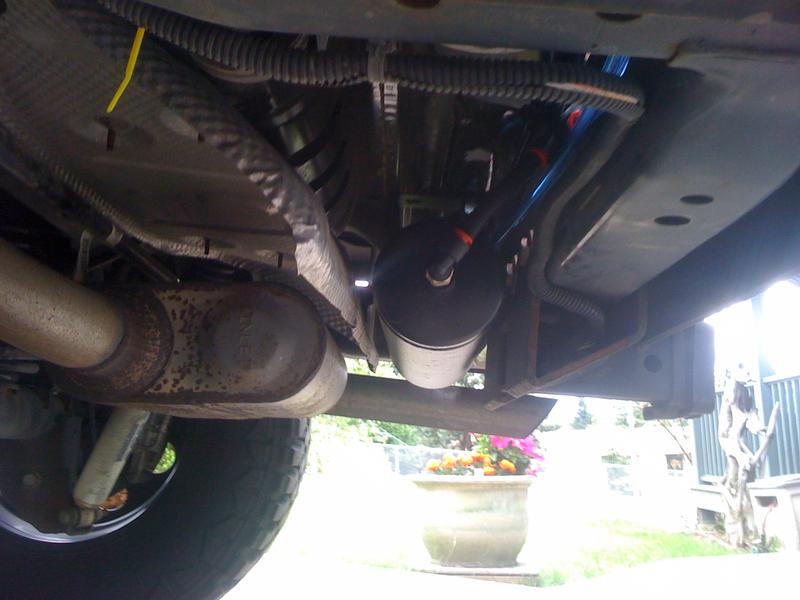

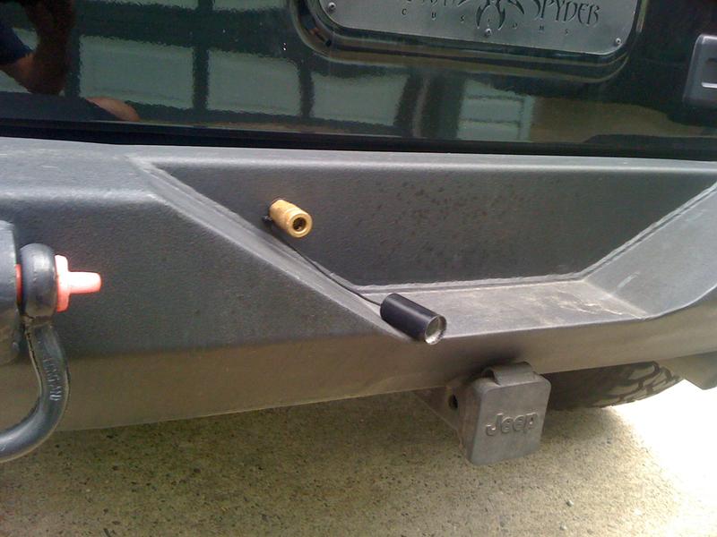

Works Like a Damn
i have since added a 1lb air tank underneath the back bumper for added air storage
and to help take some pressure (no pun intended) off the Air Comp as well as a rear quick connect

Name:	New Quick disconnect rear.jpg

Tidy install - good result.
Make sure you cap off the coupling to stop debris getting inside.

I want one of these too. Any idea yet on how long to air up a tire ?
I didn't see what size tires you have...
Anyways AWESOME INSTALL
Thanks !! im running 33" tires
According to ARB it has enough Poop to air up 4 tires 35" - 37" tires in a single duty cycle in just over 2 mins ....i tested it on my wheel barrow tire and it was pretty wick, filled a baketball fast as well .. as for Jeep tire? haven't tired that yet...below is the link to ARB's Spec
