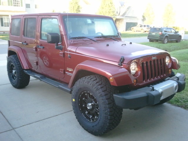

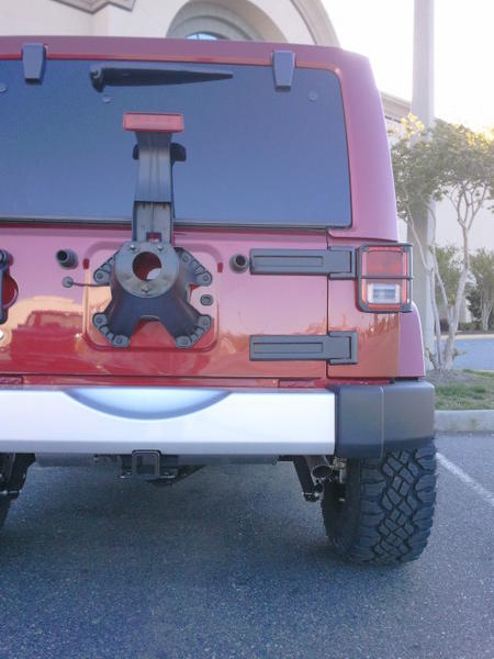

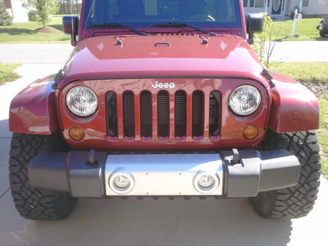

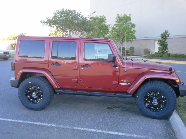

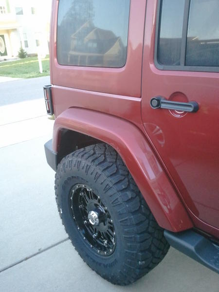

Put the 17x9 -12mm and 315-70-17 Duratracs on last night. Bone stock JK just picked up Wed. Def rub the front bumper and air dam they will both be replaced. Beyond that I hammered the pinch seam back just for good measure but there was plenty of room. MPG instantly went down 4 or so lol

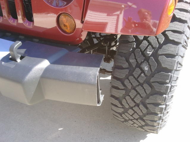

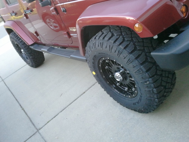

Trimmed the front bumper, still had a slight rub at full turn - it was catching the airdam slightly, so removed it. All good for now!

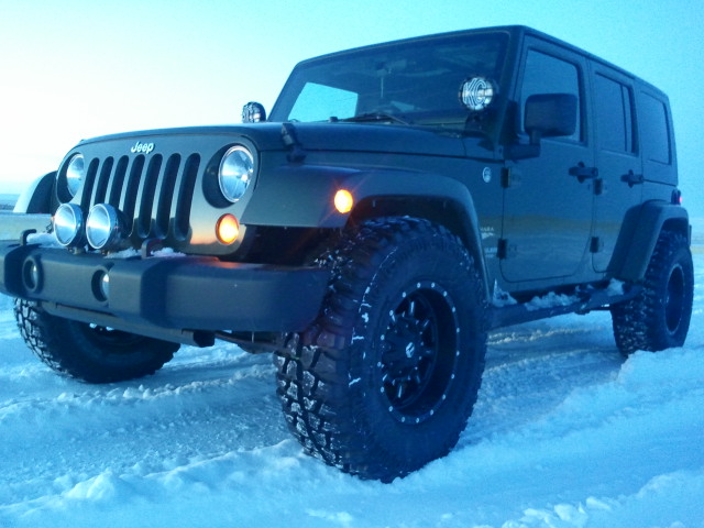

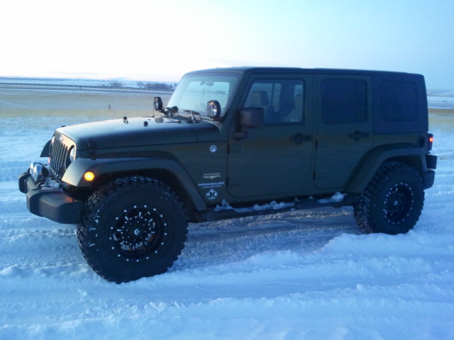

No lift, No air dam, No rubbing on road, will not take it off road till i get my lift put in. 35" Dick Cepek Mud Country tires.

Fenders are clear turn to turn. I've driven over speed bumps, no problems. I mainly drive on the beach for my offroading - so I may eventually do a leveling kit, or maybe nothing for awhile.
