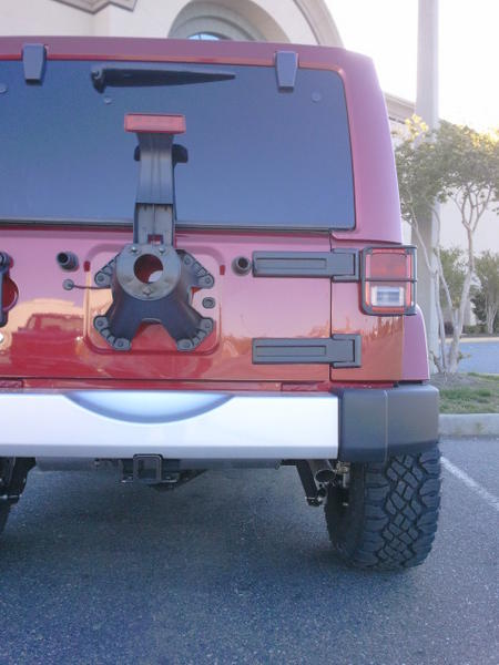

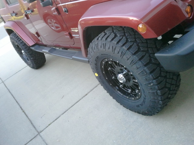

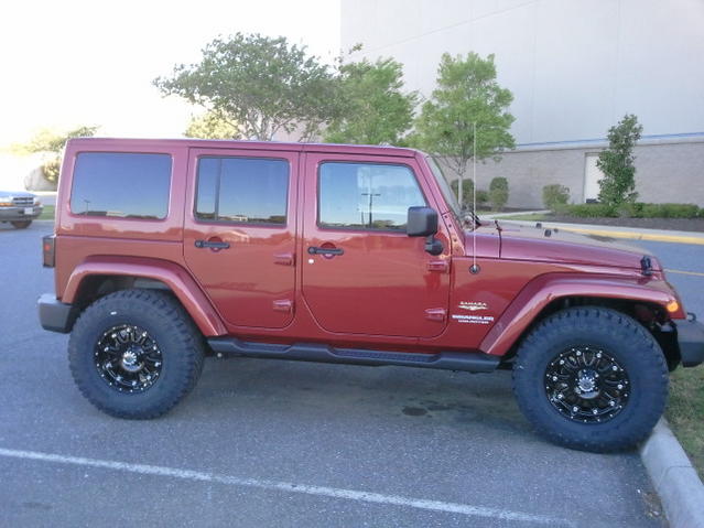

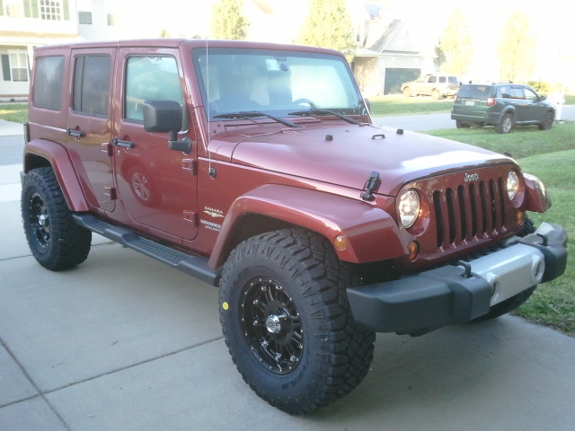

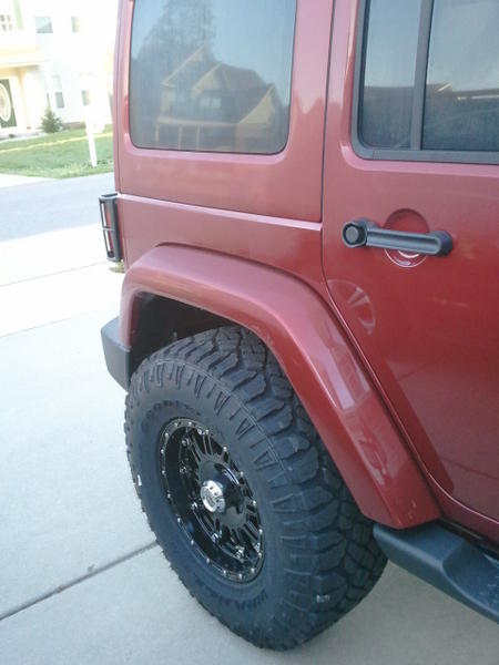

Put the 17x9 -12mm and 315-70-17 Duratracs on last night. Bone stock JK just picked up Wed. Def rub the front bumper and air dam they will both be replaced. Beyond that I hammered the pinch seam back just for good measure but there was plenty of room. MPG instantly went down 4 or so lol
Attachment 300673Attachment 300674Attachment 300675Attachment 300676Attachment 300677
Where's the spare tire??
Wasn't mounted yet, nothing looks worse than someone with aftermarket wheels /big tires and a stock spare on the back. Looks tacky and is USELESS! Lol

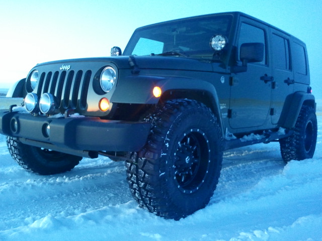

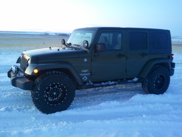

No lift, No air dam, No rubbing on road, will not take it off road till i get my lift put in. 35" Dick Cepek Mud Country tires.
Attachment 301566Attachment 301567
Are you using wheel spacers with this? I am liking this idea for my girls '12 that will never see any offroad action. How does it track going down the road with the stock steering stabilizer?
No spacers, The rims have 4.5" of back spacing, feels a little loose going down the road. I would recommend at least a leveling kit though, if you hit a good bump, you will rub the fenders with stock suspension.

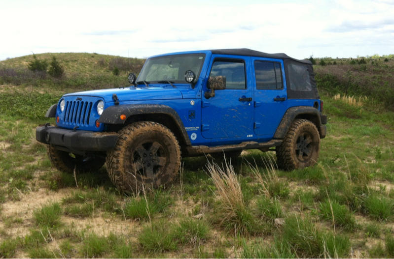

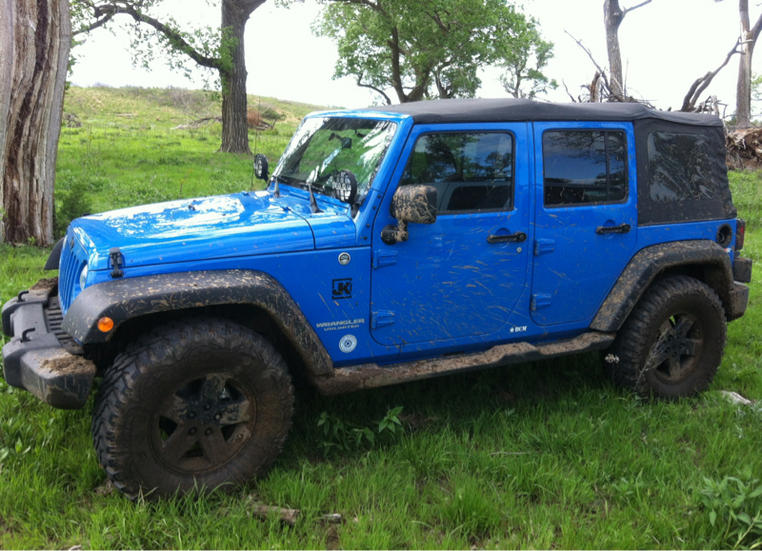

35s, wheel spacers, no lift. A little rubbing bouncing around on back roads. Rides a lot better.
