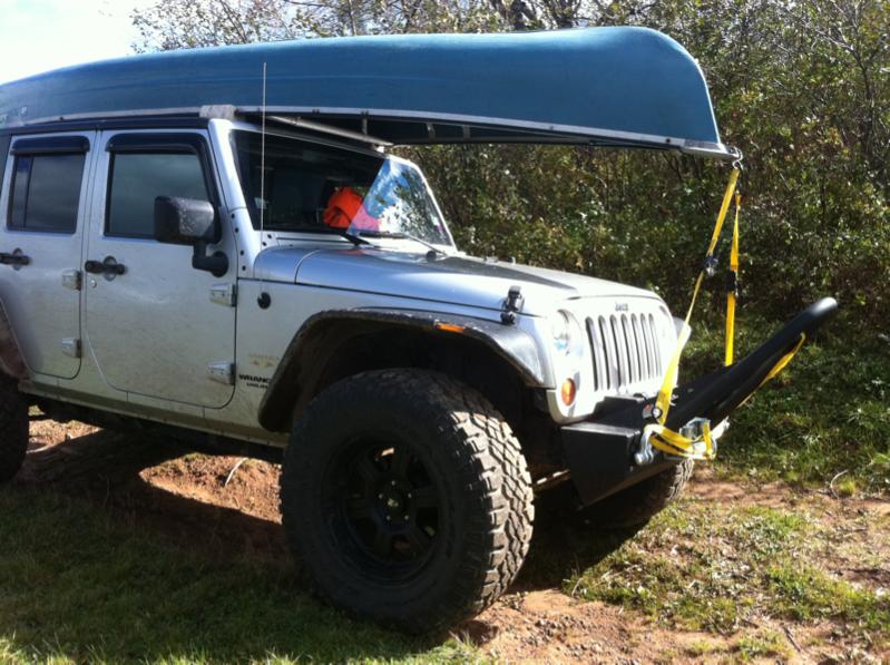

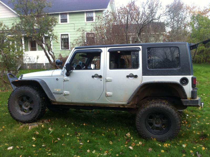

35" duratracs with a tf puck leveling kit bringing me back to stock ride height after my factory springs sagged out with bumpers and winch. Bw flats. I miss the rear pinch seam by 1/8th of an inch but I can easily stuff the tire up into the tub. The picture with the articulation is rubbing on the other side in the rear.
