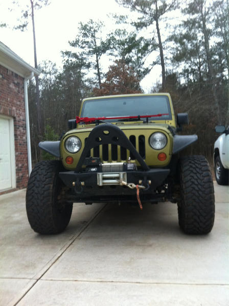

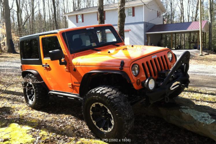

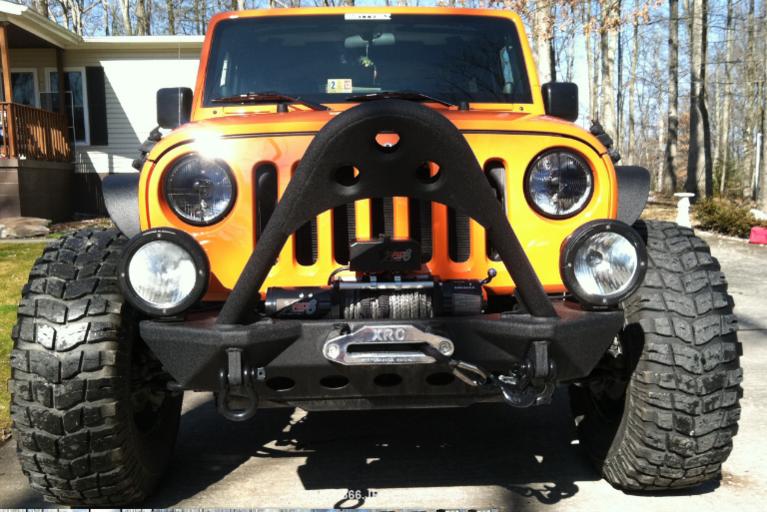

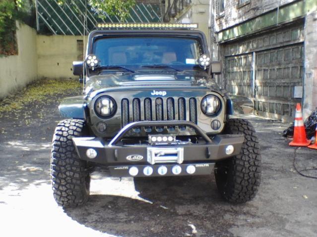

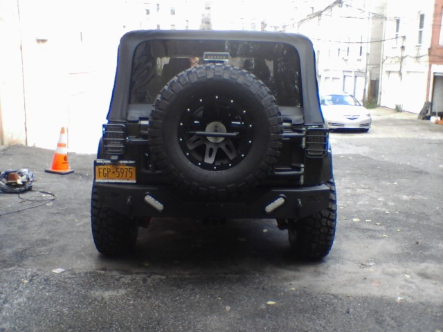

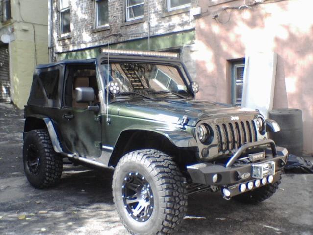

heres the general... no lift just smitty bilt flat flares

very nice jeep

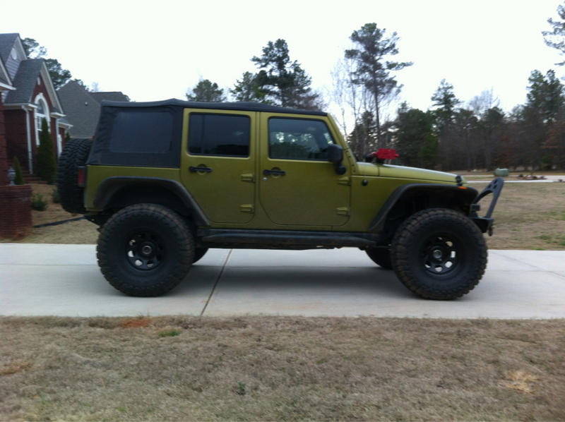

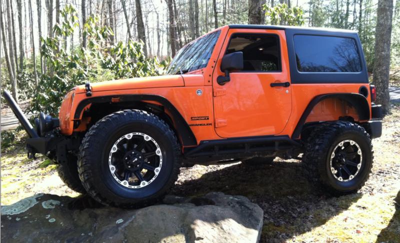

That's exactly the setup I run.

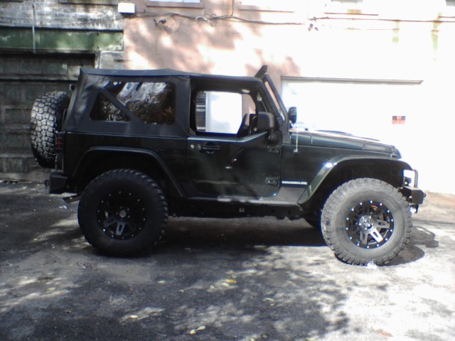

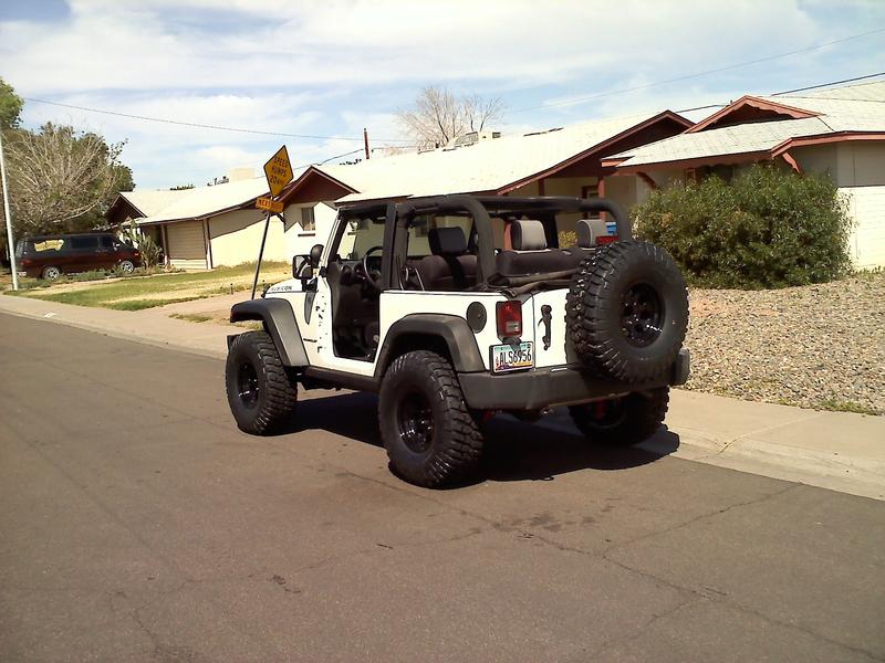

Dont be fooled. You dont need much more than a leveling kit for 35's. Heres mine that I ran for a few days.

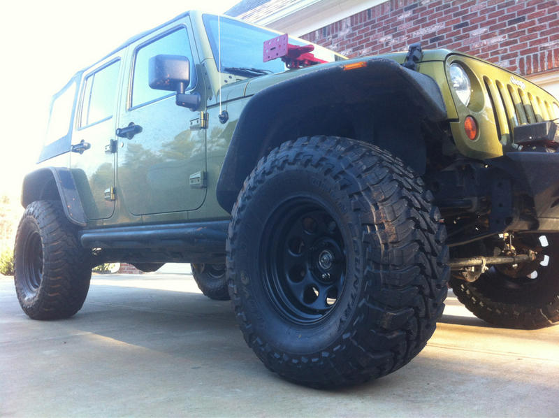

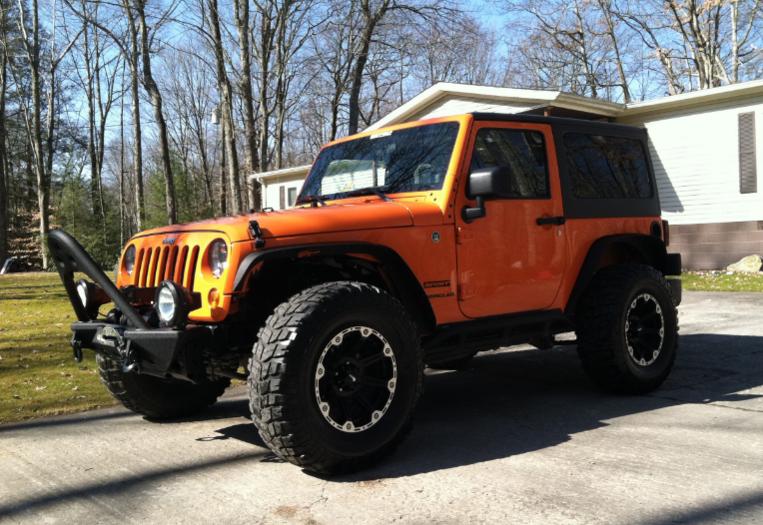

Yes 13.50's on 17x9 pro comps with 4.25bs and they hung out a couple of inches. I like the wide look so I added 1.25" spacers so they are really pushed out now.
Hard to see but this is before spacers. I had to adjust the steering stops so not to rub the lower control arms.
This is after spacers with 3" bs. No steering stop adjustments needed.

As long as you have flat or no fenders...
