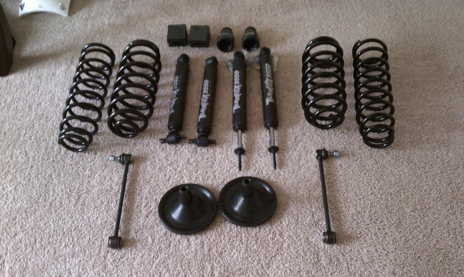

Notes on Teraflex 2.5" coil and shock install
Just wanted to add my experience and thoughts of installing this lift for others to reference...

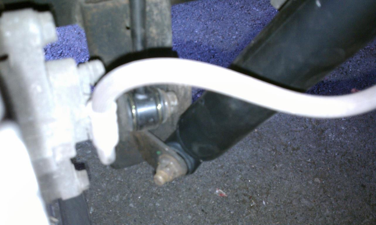

6. Most people talk about how they are unable to install the sway bar links on the rear per the instructions due to a more bulkier sway bark link provided by Teraflex. I did not have any issue with this. I don't know if Teraflex over time made an adjustment to the design of there sway bar links or if my jeep is just one of the lucky ones with the bottom sway bar link drilled in the correct position. Therefore I installed my sway bar links the way the instructions suggest to. The only issue I see is that there is only a 1/4 at most space between the lower sway bar link bolt head and the bottom of the rear shock. I don't do any serious "flexing" so I do not for see any issues with damage to the rear shock, but I will keep an eye out.

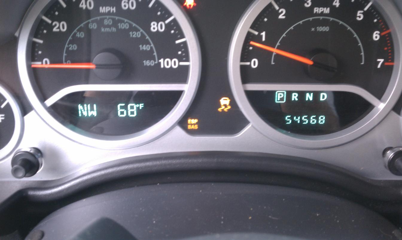

9. I attempted to realign the steering wheel, I have not managed to get it straightened out yet so my ESP/BAS light and traction control light continues to come on. If I pus the traction control button I can reactivate the traction control and everything works just fine. The ESP/BAS light remains on. If any one has a suggestion on how to fix this I would appreciate it. I loosed the two nuts and turned the turnbuckle underneath the jeep to recenter the steering wheel but it only lets me turn the turnbuckle so far one way or another and I am unable to get the steering wheel back to center...Once again, any suggestions would be appreciated.

So i just managed to center my steering wheel and get rid of the ESP/BAS and traction control light...
...the problem was that the turn buckle on the drag link had become a casualty to RUST...therefore I could not turn it enough to center the steering wheel. Well, after spraying the turn buckle with some liquid wrench and a few hours later...the turn buckle turns and I centered my steering wheel and NO MORE WARNING LIGHTS...
...although, I had to rotate my turn buckle about 3 times, most people seem to only have to turn it 3/4 of a turn. Guess I'm just different. Oh well, lift is on and everything is in order!

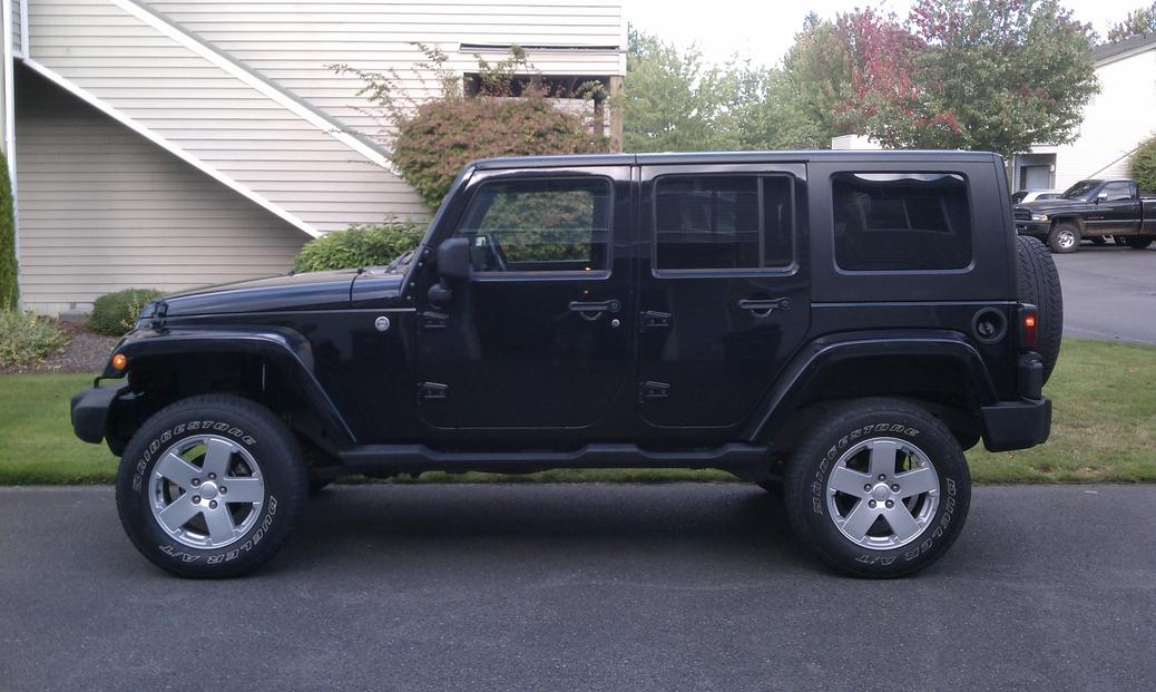

Jeep looks great, you did an awesome job. She looks good with her new meats on as well. How is the ride, any shimmy at all? I'm def looking into getting the teraflex 2.5 coil lift as well so any info on how she rides with the lift is greatly appreciated
