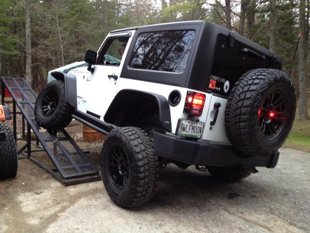

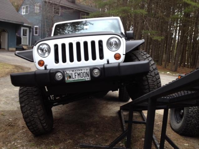

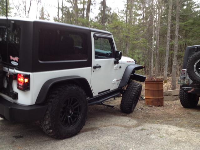

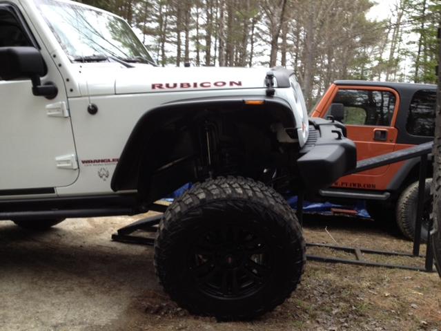

Just installed the Teraflex 2.5" lift with shocks/coils. Got to say the ride quality is much better than the leveling kit with stock coils/shocks. Here are some shots on the RTI ramp. Basically just checking for brake line issues etc. Enjoy!

NICE, looks great.

Looks really good. Did you install the front and rear bumpstops? I have more room before my shocks completely compress and was thinking of taking my bumpstops out.

how did your front brakelines look? i had to take my front bracket off cause they were a little tight

The front bump stops are limiting my travel about 2-3". I'm going to leave them in for now.
As for the brakes I had to remove the bracket and use some zip ties to attach to the shocks. Works great with no problems! I may replace the zip tie that is around the line itself with a plastic brake line clip.....I think it would work a little better and cut down on wear.

Very nice! Does that kit also level it to get rid of the rake?

yup. Until you put a bumper and winch on it.
