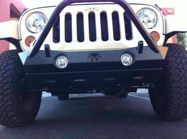

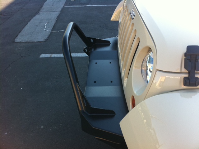

I have a 2012 with the Brawler Lite Bumper from Poison Spyder. I contacted Poison Spyder prior to purchasing the bumper and they stated there were no issues with the vacuum pump. When I installed the Brawler Lite Bumper, I had plenty of clearance so I had no need to relocate. Only certain bumpers require you to relocate I believe. I kept my crash bar when I installed, you just have to trim it down a bit. I matched the bumper up with the Brawler Lite Skid as well. Other then being a pain in the ass to install, I love both the bumper and the skid.
I have my WARN winch going on today after breakfast.
Name:	side bumper.JPG
ID:	261652   Click image for larger version
