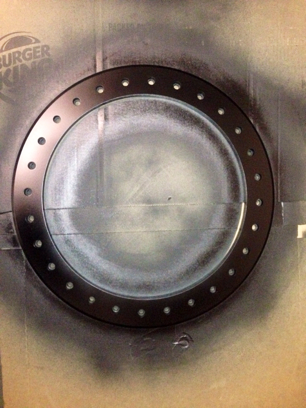

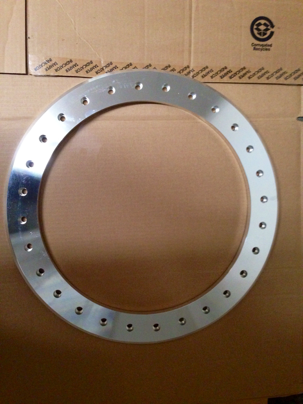

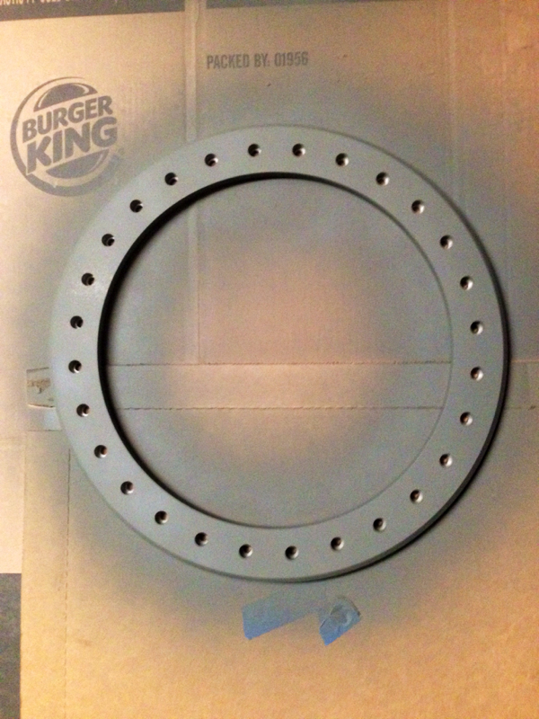

Just getting mine finished up today...
320 grit dry sand
3 light coats of rustoleum self etching primer - dry over night
600 grit dry sand to the primer
3 light coats of rustoleum satin black - dry over night
600 grit dry sand to satin black
1 complete wet coat for final
They are in the final drying process now. Ill let them sit for a few days before mounted. Im sure I did more steps than necessary to paint these, but everything looks good so far

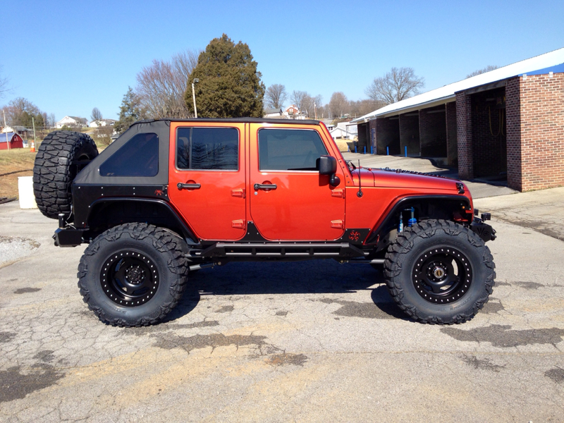

Rugged ridge wheels

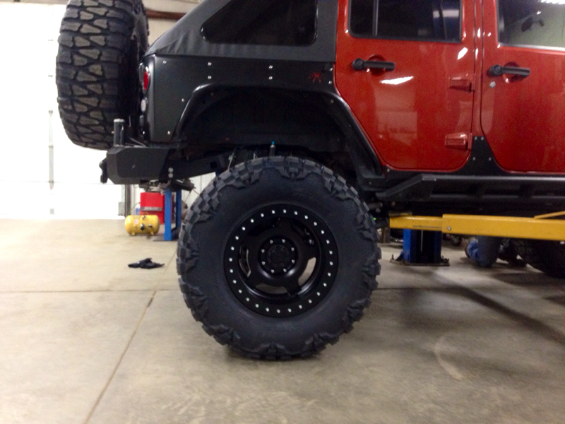

Installed
ID:	636909   Click image for larger version
ID:	636910   Click image for larger version
