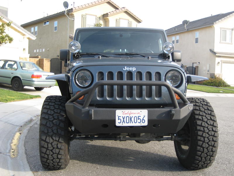

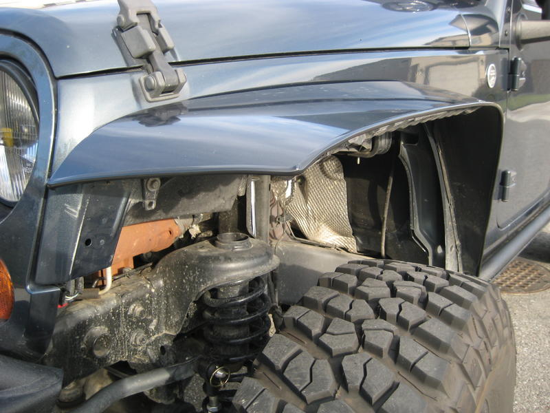

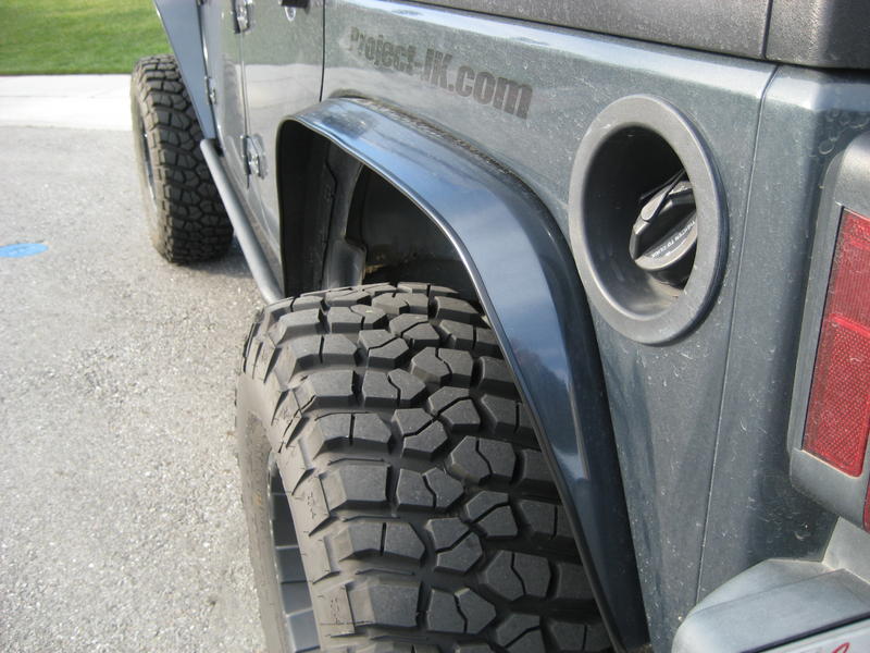

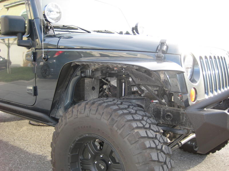

My wife was just happy I saved her $500.

Looks great! Saving $500 to boot.
