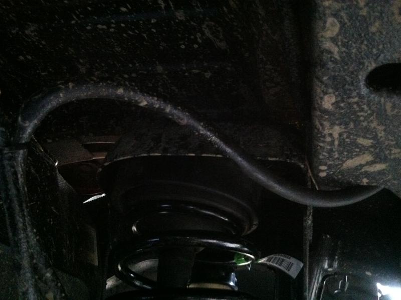

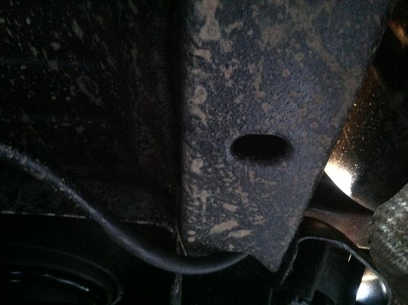

I know this has probably been covered 100 times, but sometimes it's nice to see things again and maybe a different way of relocating it...
I just did this a few minutes ago, hope it helps....
9/32 vaccum hose with 3/8 vaccum connector. I added on without replacing factory hose. Zip tied it to E-brake line and frame and ran it up through frame into rear driver tail light so it would not catch on anything...
The connector is up in frame and I sealed connectors (aftermarket/factory breather) with electrical tape just for precautions...
I also left about a 1 1/2 feet of flex or more, just in case I need to modify it at some point...

Used same vaccum hose 9/32 1" and same vaccum connector 3/8 . The connector is slightly bigger, but has a tighter seal. Both front and rear consisted of 2 vaccum connectors, 8' of vaccum hose, 8 zip ties ($19.41) and 20 minutes of your time.
