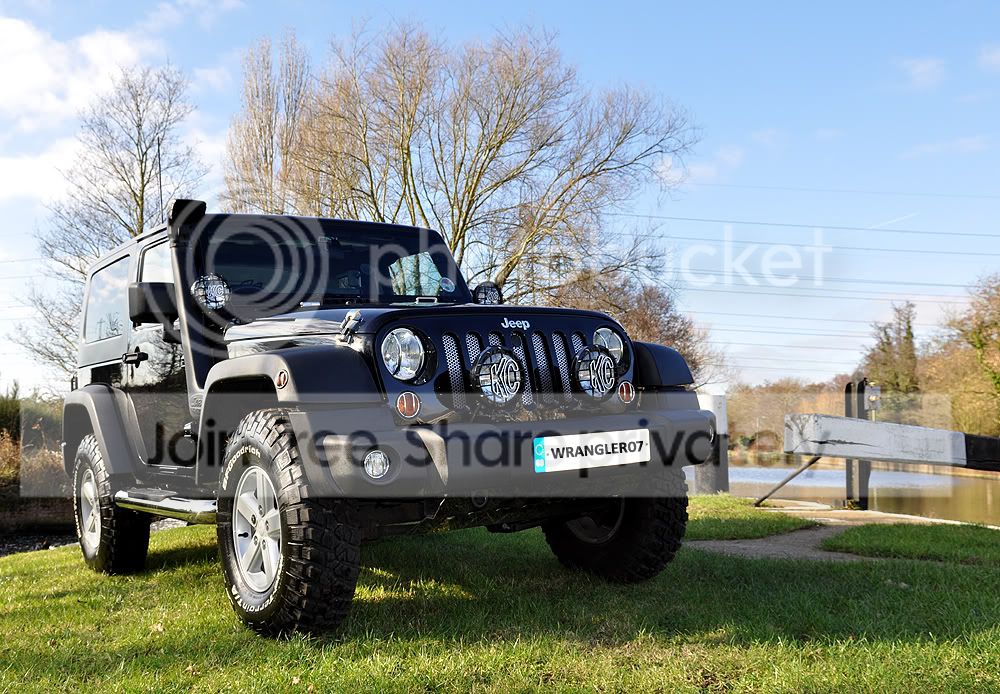

Well, finally got my Safari snorkel installed and all the breathers raised. I preferred the way the Safari version slotted in through the quarter panel and fender as opposed to along and through the hood. Couple of things to watch out for with these. Once you chop the quarter panel that panel is weakened and not really held in place well. It needs some attention to properly bind and fix it again, otherwise you'll end up with a lot of vibration that many complain about on the Ozzy forums. Also, the brake tubes will need a little bit of bending to get them to completely avoid contact with the fender pipe. If you don't do that they will be compromised and also a hole will eventually be worn in that pipe, neither of which are desirable.
On the 6 speed manual it's breather is a pain in the butt to get to but it has to be done. It's apparently much simpler on the autos.
Lastly, before installing this, I was getting some annoying vibration during acceleration which I'd put down to a small nut that had dropped inside the hood. It wasn't that at all, it was my little 8 inch stubby antenna that was causing it. A little silicone dampening at the base stopped it and now all is peaceful once again.
BTW, mine is a 2dr 2.8 CRD.
Here's a couple of pics. Haven't done any of the engine bay and fender area but if anyone needs some just let me know:
Here's one showing how the 8" stubby antenna and Mopar light brackets work with this setup:

Just wondering if you get any loss of front / side vision with the snorkel now being installed, especially being a RH drive. Plus any increased noise ?
Looks good though.
Still waiting until mines out of warranty before considering any mods.
Old Jan 31, 2011 | 03:05 AM
wrangler07's Avatar
Posts: 802
From: Surrey, UK
No, no decrease in vision at all. It sits hidden behind the windscreen pillar so uoi can't even see it. The only thing you'll see is a bit of the filter at the top. With the windows closed on the hard top there's zero wind noise from it. With the driver's window down you notice a bit but nothing too bothersome.

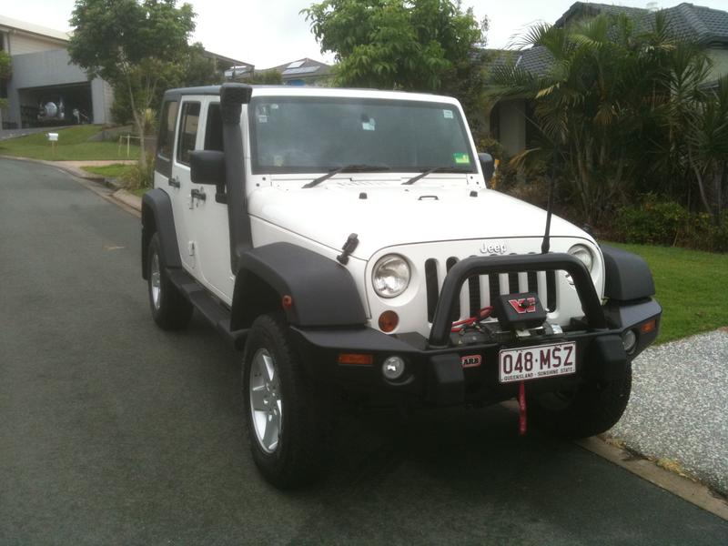

Hello Mate, I just had a question... I had my snorkel and OME lift installed did you have any vibration on yours after install? I know you said the did a stella job on yours, ARB spent 9 Hours on mine and they have asked me to bring it back because they can not find the vibration, they have been really good as well, just thought id ask see if you knew?
Name:	Jeep OME Side.jpg
ID:	127563   Click image for larger version
Name:	Jeep OME front.jpg
