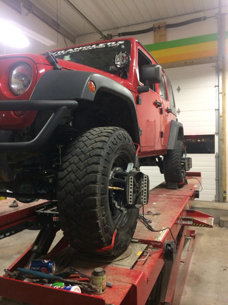

3.5" X Factor on 33's. Just installed tonight. Only pics I have right now lol

What did you set your caster at? I think I have mine right around 3.5-4 degree's, but this is checking the best I can with an angle finder on the pinion flange.
How much lift did you gain from the kit?

What did you set your caster at? I think I have mine right around 3.5-4 degree's, but this is checking the best I can with an angle finder on the pinion flange. How much lift did you gain from the kit?
I set my caster at 4.2. Which is in Hunter Specs and is dead on. I set mine on my buddies alignment rack. (Hunter is the brand of the rack). I gained like 4". I forgot to measure before I started lol
