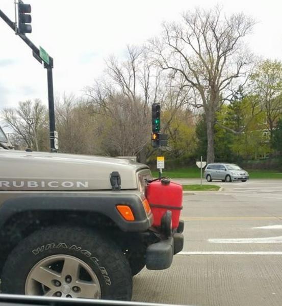

What about this setup? (Stolen from the random pictures thread)
<img src="https://www.jk-forum.com/forums/attachment.php?attachmentid=607902"/>
Looks like a bad accident waiting to happen..
