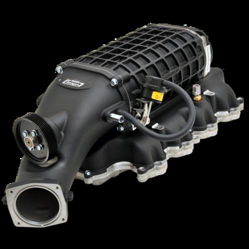

Well, then here...
Compliments of Magnuson Superchargers.
Mustang V8

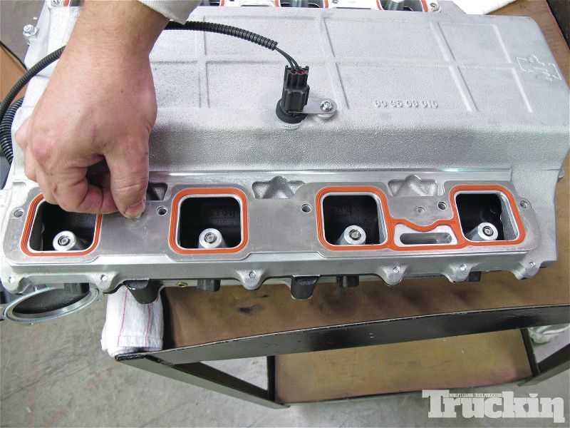

Dodge 5.7 hemi
Name:	IAT sensor.. boom.jpg
There's 2.
Like we have said before, just trying to put the right info out there. No, not all positive displacement superchargers have it post compressor, but it is the optimum placement.

And Like I said, the s/c cobra, GT 40, Saleen as well as the S/C vettes have the manifold bolted to the block with no MAF between the sc and mani.
again,
Im not crapping on your product as I have never used it in your application but from my experience tuning Hondas, the vortech S/C acted very turbo like in their power delivery where as my Jackson racing had a boat load of torque and not as much top end....
Feel free to shoot me one of your systems for evaluation....I can guarantee that it will get a fair and honest review....
And btw, im not calling names etc or shitting on you for posting over here......I am just stating my experience with s/c's in general...im not that imature.

Intake air temperature, not maf. The compression of the air creates a ton of heat so the air measured before the blower will be significantly cooler than the air after the blower.
