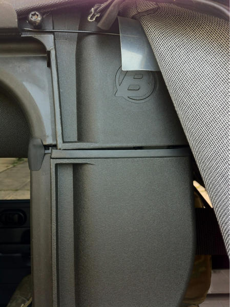

Before I button everything up the door surround seals. After I snap the header in and pull back the window, I get this happening and I believe it is letting water in.
I am toying with the idea of silicone sealing it. I've tried a different door surround and no help.
Are others tops look like this too or are you getting good seals?

Mine do that as well. I put some of that adhesive weather stripping I talked about a few posts back between those two pieces, then when the door surround is in place it seals up. So far the water has stayed out...
