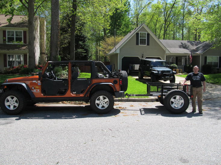

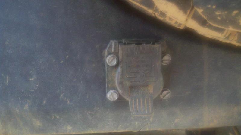

Default Trailer 7 point hook up
Name:	trailer plug mod.jpg
ID:	163104This week i moded my stock bumper by moveing my trailer plug in to the bumper.
1. 21/8 hole saw to cut thru plastic and some of the metal cross member ( I only cut 1/2 inch in and 1/2 down give or take.
2. Remove plastic bumper remove plastic test fit plug.
3. Hammer the cut peice down . do test fit with bumper and plug.
4. Run connection wire over cross member . Install bumper with out plug. Pull wire thru hole.
5. Conect plug and wire connection. Screw in done.
Why did i do this mod simple it has been ripped off 3 times and i have strated my trailer build .Click image for larger version

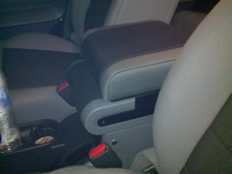

While at the Houston Jeep Fest I picked up the Rugged Ridge arm rest ... man that arm rest is an awesome thing to have.
