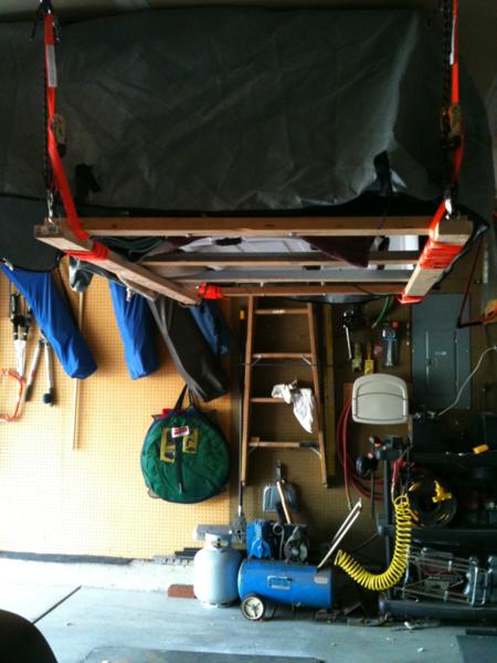

Originally Posted by Orangeav
Just hoisted the hardtop to the garage ceiling with a homemade rack and pulley system. Now I have the wife- mobile parked under it... I doubt I'll sleep tonight hoping I did everything correctly...lol!
Mind sharing how you did your setup? Got pics?

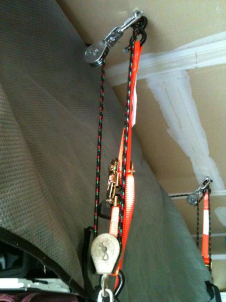

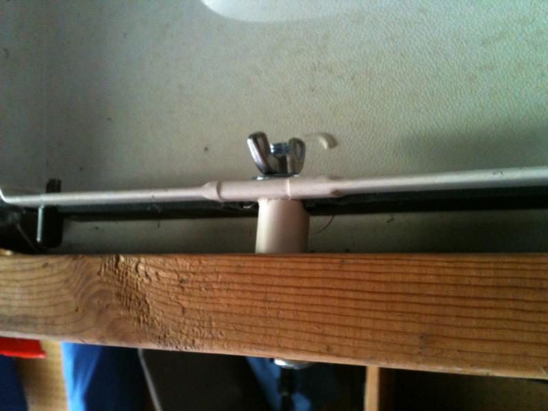

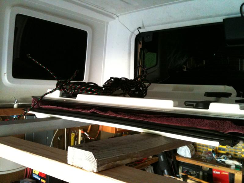

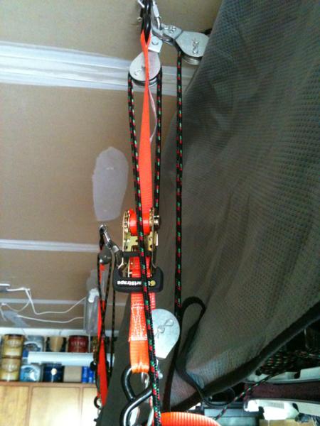

Sure!
I built the frame to evenly distribute the weight of the top without suspending it like some racks do, plus I was then able to make the shelf for the Freedom Panels. From there I put 6 foot ( should have been 6 1/2) cross braces for lifting. I have eye hooks in the ceiling joists and the lifting frame. Next I added the pulleys to all the eye hooks and ran the ropes. It takes a little time to make sure you get an even lift, but it more about storage than speed for me. I put tiedown cleats on the wall so I could go back and forth between the 2 ropes. Once I got is close to the top I put the ratchet straps on to take the pressure off the pulley system. All the orange straps wrapped around the frame is just to keep it out of the way. The cover is an old cab cover I had for my last F-150 S-crew. Fits good enough for me!
