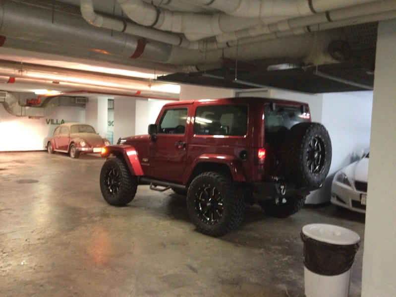

Installed 4" lift kit and new 35" wheels and tires
Changed the front rear bumpers
Side steps
Front and rear drive shafts
Xrc 10 winch
Thinking about changing the sway bar the steering is a bit tilted also I need more power these wheels are heavy
Any suggestions?

Looks good. Did you use a Procal to calibrate your speedometer? If you have an auto trans that will help with the shift points and give you back some power. You can start off with an aftermarket exhaust like Dynomax, Magnaflow or Flowmaster. Other than that a programmer will help with some extra ponies, but the aftermarket companies haven't found a way to crack the computer....Lastly would be regearing to 4.56 or 4.88...

Thanks for the input
I didn't use the procal cuz mine has a manual tranny. And I'm using the gps on my phone to know the speed difference.
Hopefully I'll save some cash and install a good exhaust system.

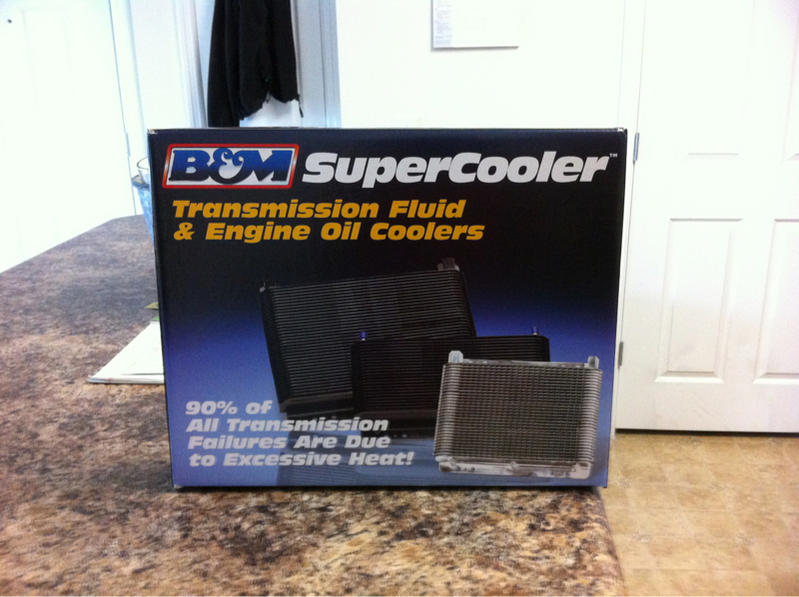

Nothing today but got my tranny cooler in to be installed this weekend .
