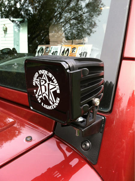

Rigid Duallys long range and Rugged Ridge mounting brackets

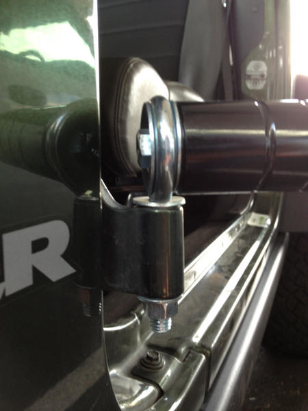

Repurposed my son's BMX peg into a Jeep foot rest. I'll flip it over because it's a bit too high as is.
Great idea! I wonder if a Harley highway peg would work. Looks like a super idea!!!
Please show how the peg is attached.
Man those look great. I'm really wanting a set of these. How difficult are they to install?
Really easy, about an hour from start to finish. I took my time and made everything as clean as possible.

I got the idea off of another forum...
Here are the parts needed:
BMX foot peg
One 3/8 x 4 eye bolt (if I remember correctly)
Two 3/8 fender washers (I cranked these until they were dimpled to keep the eye bolt somewhat centered)
Three "normal" 3/8 washers (one inside the peg, two above and below the hinge)
One 3/8 x 1 1/2 bolt (holding eye bolt to peg)
Two 3/8 nuts (one inside peg, one on eye bolt)
Hopefully this helps. Attached is a close up.
