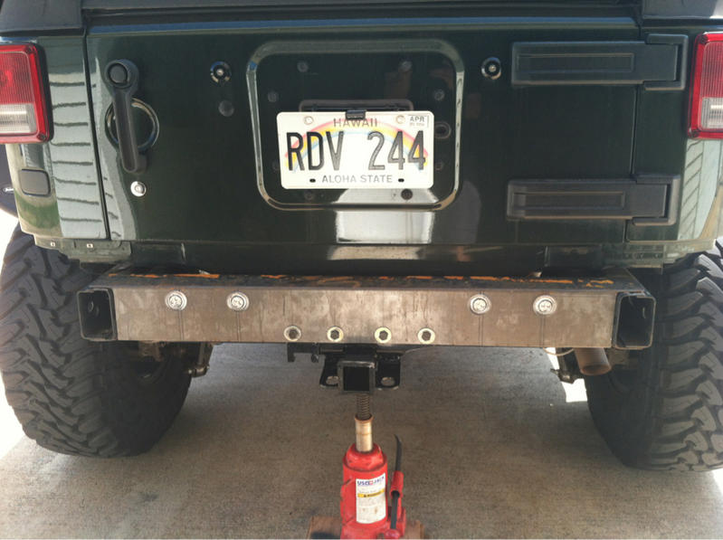

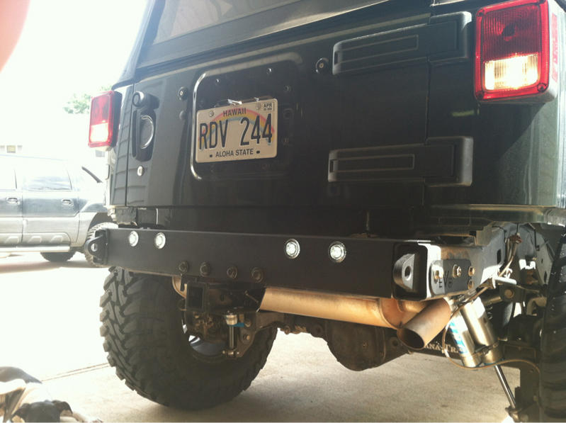

Can't really say I fab'd it up because it is just a 1/8 plate steel with a 90 degree bend. Had a metal shop bend it for me. I notched the side to fit the Evo d ring mounts. I got the idea from another forum member who cut up a piece of 3 x 5 square tube and used that. I couldn't find one of those in Hawaii so I went this way instead. It worked out well. I then cut four 1 1/4 holes to fit the gen right led lights for reverse lights. Here are some more pictures.

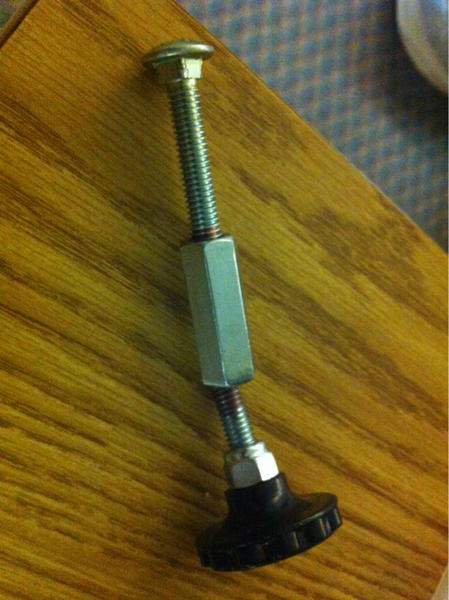

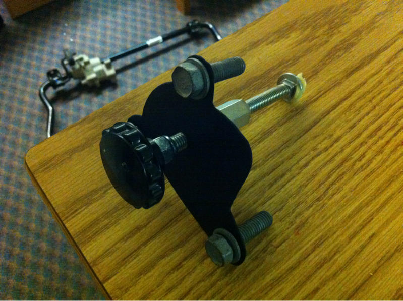

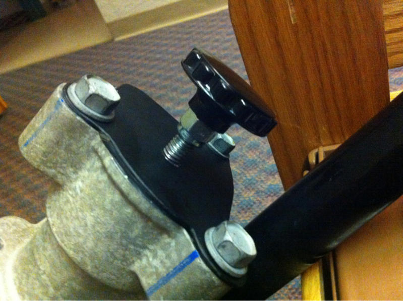

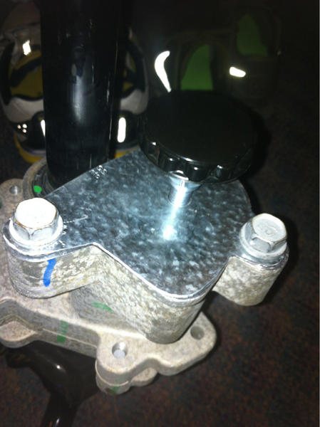

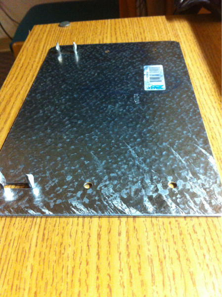

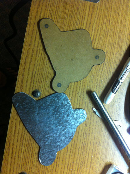

Made my Ace Hardware manual swaybar disconnect lol

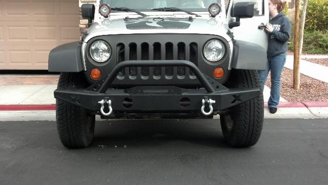

BUMPERS! Finally!

It looks awesome, might steal this idea

Wow I've never seen this, but i really like it. Looks clean and finished. I may look into this.

Man that looks really nice!! Good job
