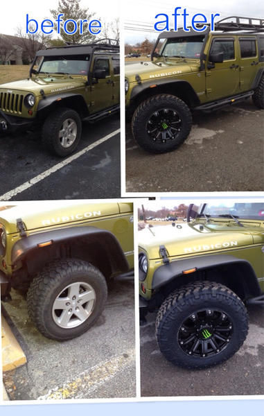

New Monster Energy Wheels and Nitto Trail Grapplers

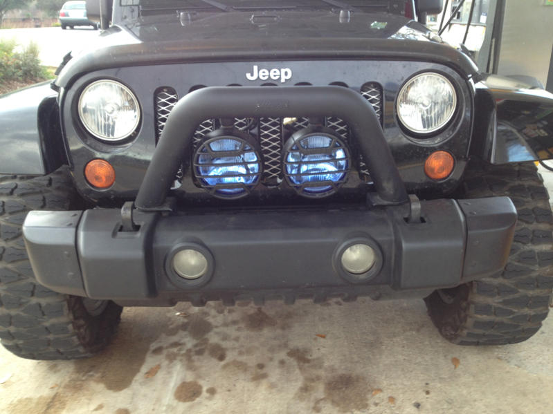

Did grill mod today

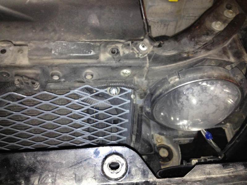

Originally Posted by Tyreelp
Did grill mod today
How hard is it to remove the grill to do this?

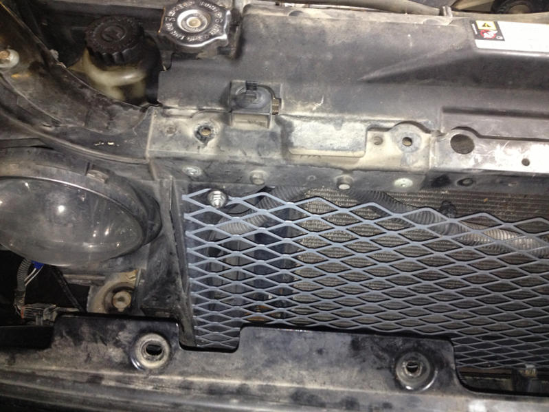

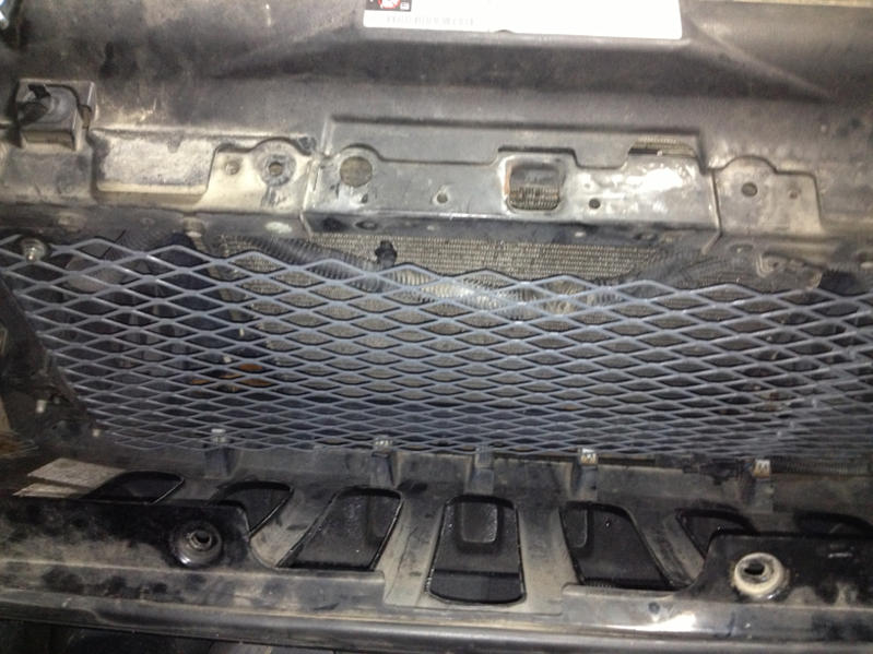

I used 13g steel and came out great nice and strong

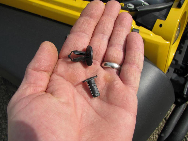

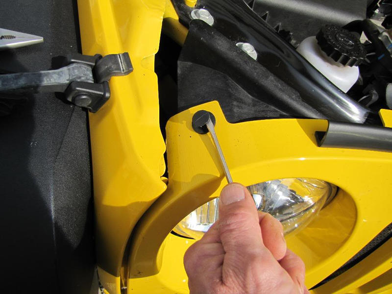

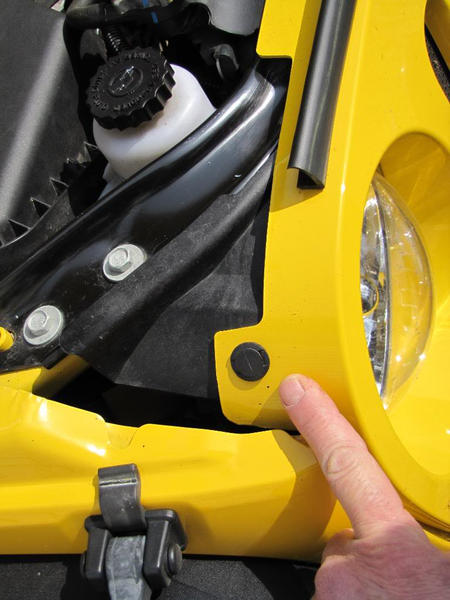

Removing the grill is just about the easiest thing you can do on a vehicle in which almost everything is easy to work on.
1- Open the hood.
2- Remove 6 plastic fastener pins along top.
3- Unplug the turn signals.
4- Pull out the grill.
5- Crack a beer of your choice.
6- Take a sip of your freshly cracked beer.
7- Bask in the glory of your mechanical skill.
