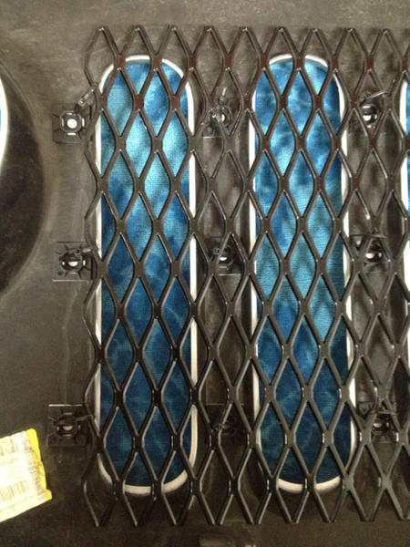

Originally Posted by BrightSilverRubicon
I did the grill mod. I used 10 gauge expanded metal from Ace Hardware. I think for the 24"x24" metal, spray paint, mounts, and zip ties. I'm in for about $43.
What mounts did you use

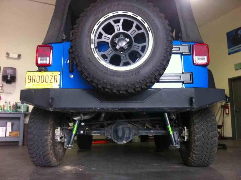

Rear upper and lower adjustable control arms. It moved my axle back about 1 1/4 inches. Now it centers up in the wheel well again. Not to mention they are much beefier and more flexible than stock.

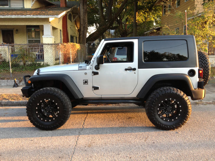

Coast 1310 Front Driveshaft to get the flex out of the RK XFactor. Teraflex tire carrier for 35s.

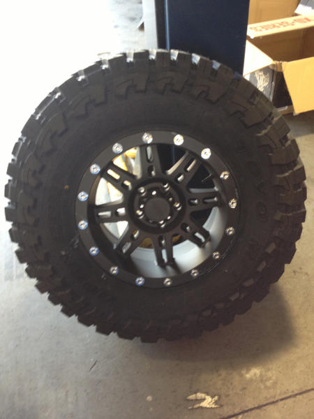

Originally Posted by Billbikes
Much less than everybody else has done, but having my 33" Nittos installed. Putting the Teraflex leveling kit on tomorrow.
Nice wheels, got the same ones.

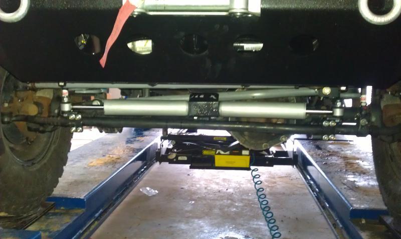

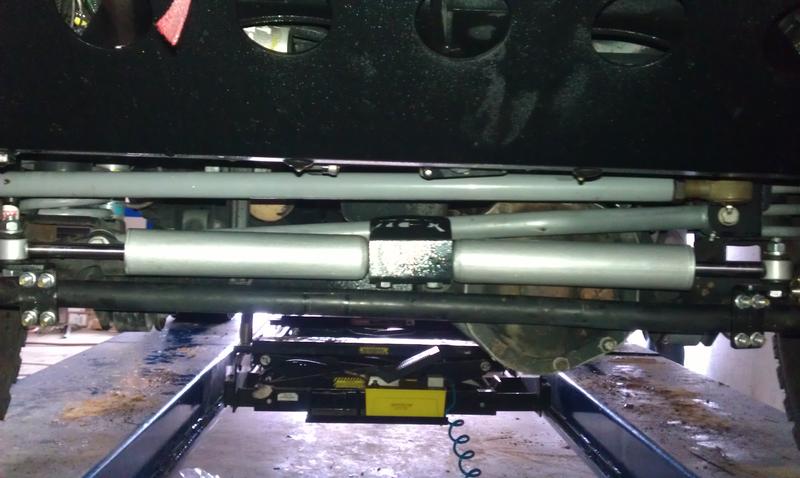

Well I finished the steering!
I was able to get my guys at Maximum Elevation in Paris TX to help me out with this one!
Thanks Collin, Jay & James!!!
If you ever need any help and you are in NTX go see Maximum Elevation or if your in Moab This week they are there as well.
// Maximum Elevation
Due to the Drag link being a RE Link and not stock we had to do a flip from the under mount to over mount on the knuckle that gave the arm plenty of room to be able to mount the passenger side portion of the RC dual steering stabilizer as you can see in picture 1
Then we changed side on the outer mounting tabs on the stabilizer kit and that pushed the shocks out just enough to give us plenty of room for the track bar. Which means no more caved in stabilizer shocks "that's a good thing!"

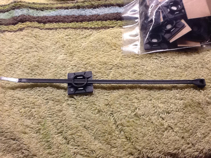

They sell 1x1" mounts made for zip ties, they are in the electrical dept in any home improvement store. These are what I used. Just male sure it's warm enough for them to stick.
Yep, this is what I used. I found it a lot easier to use 4" zip ties and feed them through the mounts that u put on the back of the Jeep grill. After you feed them through, you can lay the metal grill over them and use needle nosed pliers to grab the zip ties. There are probably a million ways to do it, but this was pretty easy for me.
