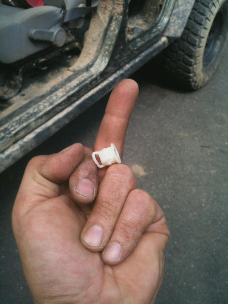

Headed out on the trail. My son goes to switch into 4wd and the lever is loose. I went through this in April of 2012 and had the replaced the crappy $0.30 piece under the console. I took the center console off.....it's fine. Look under the Jeep and discover they use the same piece at the transfer case. Definitely installing a Advanced Adaptors linkage!!!!
