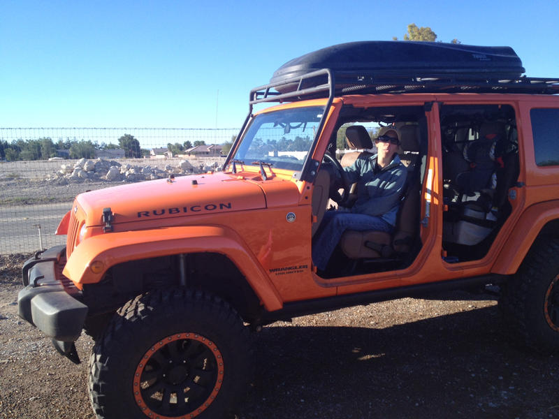

Took the doors off a real pain to take top off. I miss the mirrors a lot though.

There's several types of mirrors that can be used when doors are off. Mine bolt in where the door pin goes. Check out 4 wheel parts or quadratec.

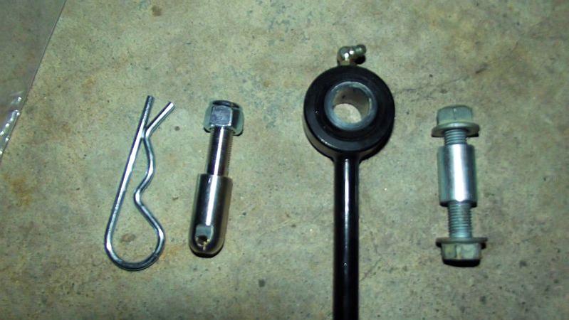

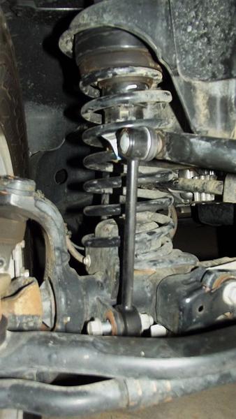

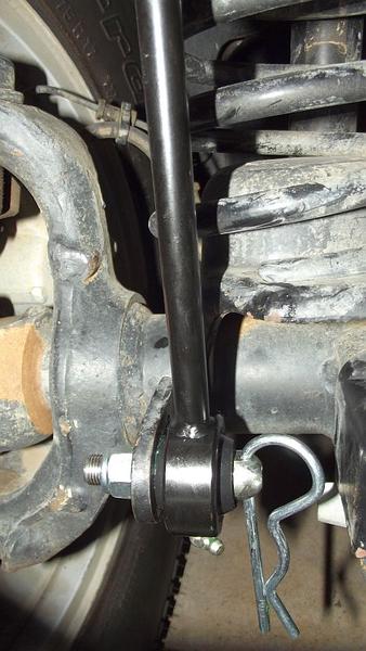

Replaced the lower sway bar link bolt with a Teraflex quick disconnect bolt. I had the Teralfex Leveling kit and it came with longer sway bar links.
I had to buy 1/2" lock nuts at Lowe's to mount the bolts to the axle. I think they are 1/2" - 20's. Needed two. And I used big hitch pins as retaining pins on the bolts. Don't remember the size.
I also had to punch the bushing out of the lower part of the way bar to fit the 3/4" quick disconnect bolt through. I got a big bolt to use as a punch and a BFH. A BFH is a big F-ing hammer for those who don't know. I used a 10 pound sledge to slowly tap it out.
