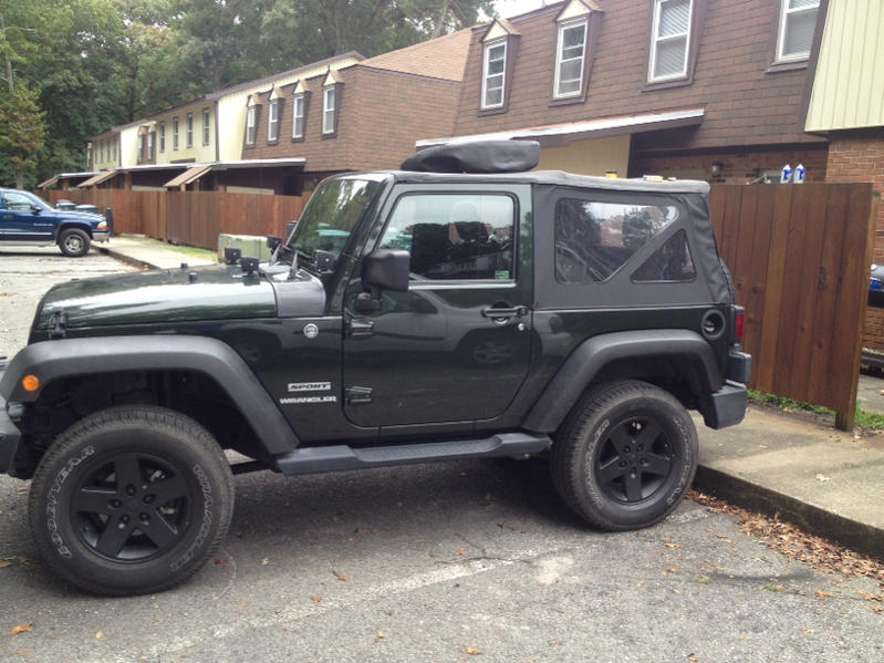

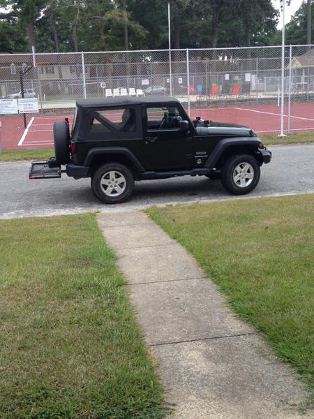

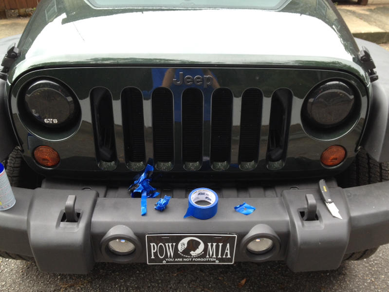

Went to the dark side!! Black out headlights, blacked out rims and "Jeep" emblem. Included a "before" shot for comparison. Even had a visitor from a black cat for Halloween! Thoughts???? KCJO!!

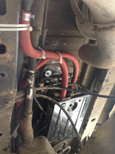

Evap relocation. 5 foot of 5/8 hose, 4 hose clamps, 4 1" bolts and nuts and fender washers. 2013 4 door, using stock mount bent up.

Dump hot exhaust on rubber hose and turn muffler into a water trap? I could be wrong but I hope I'm not right.

How long did that take you?
That's not the end of the exhaust pipe, it's the bend over the axle.
About two hours. Taking my time with a buddy, and beers. Also did a rear driveshaft boot in that time. Pretty easy mod, and gets it out of the way so I won't rip another boot!

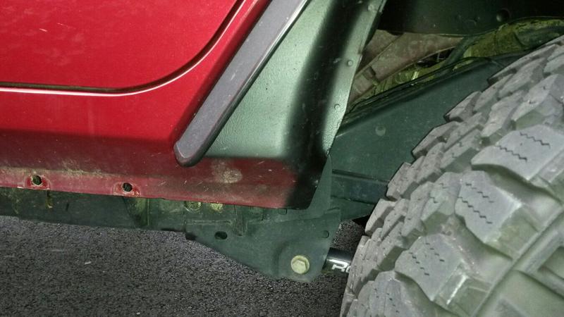

Bought a new reciprocating saw, then cut my pinch seams and Rubi rails to make room for some new 37s going on tomorrow...
