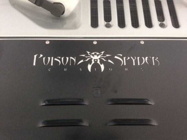

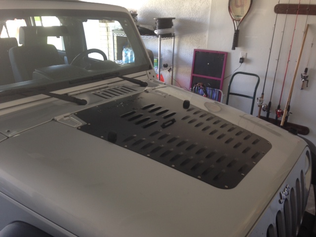

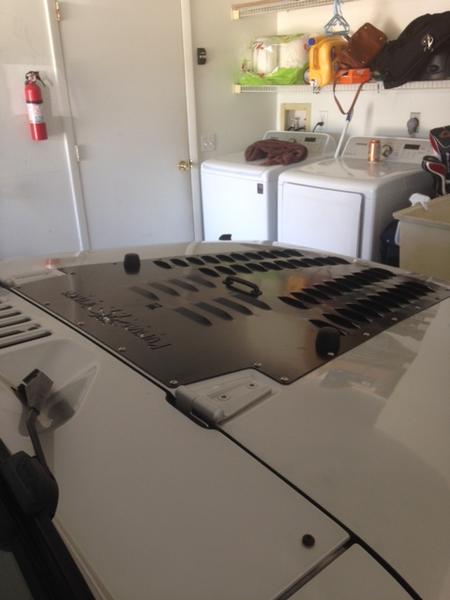

Finally completed my first modification to the jeep this weekend. Installed the Poison Spyder hood louver.
Next weekend will be a TeraFlex 2.5" coil lift.

Love the looks of that hood

How hard was the install? Did you do a write up on it?

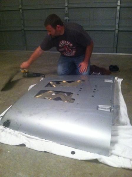

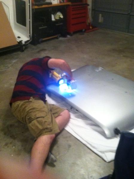

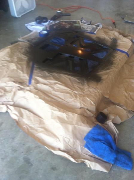

It wasn't to bad, took a little longer than I had hoped. I removed the hood and had to work on the floor, no real workspace at my house. Using the angle grinder to cut the holes in the hood was the most stressful for me. Never used one before, and it was really easy to cut through the hood and bracing underneath. Also when you are doing the final installation don't tighten the bolts to tight, really easy to deform the hood and make it look wavy.
I have read of guys installing this in 3 to 6 hours, I could see that if you had experience with the angle grinder and had a proper work bench to work on. Mine took so long, my wife had to drive the Jeep to the store with no hood. She was not happy.
