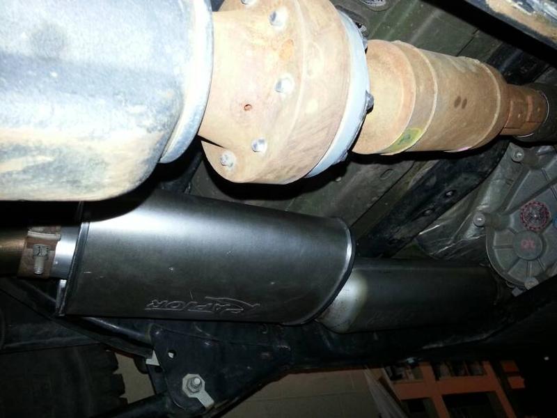

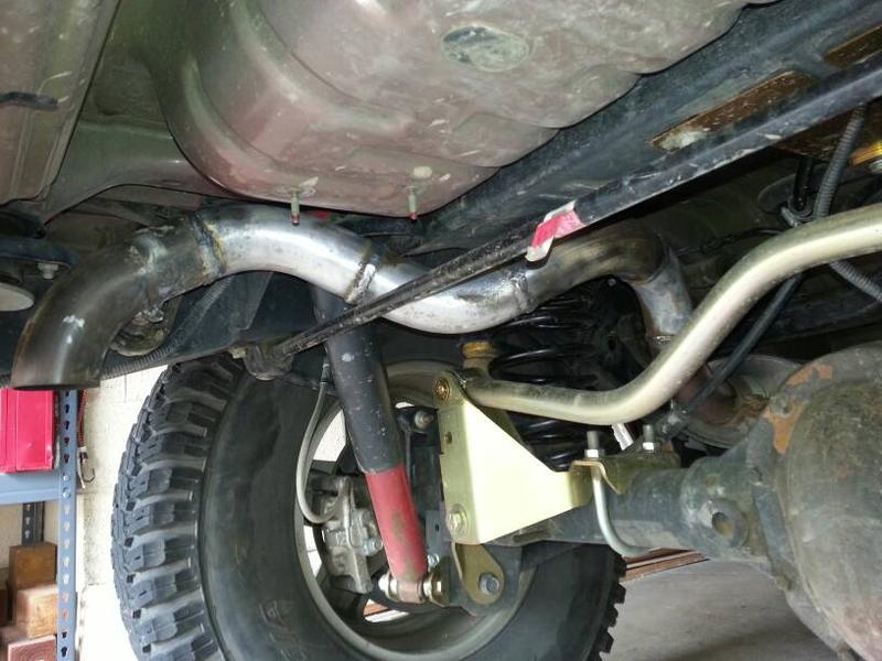

Originally Posted by Rob50lx
Made an ugly but functional tailpipe after I relocated the muffler on my 2 door. I just used leftover exhaust pieces I had laying around.
I tried a turn down after the muffler but it was so loud and a really bad drone. My exhaust sounds good now and is still a little louder than I like but it is tolerable.
Attachment 565105
Attachment 565106
Sent from my d2lte using Tapatalk
Why not just reuse the stock piping? It already dumped out right over the axle
There are a couple reasons why I needed to make my own tailpipe. I have a Flowmaster Hushpower resonator and muffler before the axle on my 2 door. That was a tight squeeze and the muffler exit was a lot closer to the rear axle and required a different bend than the factory exhaust at that point. I also wanted an ultra high clearance exhaust that went all the way to the back bumper. My exhaust fits above the rear sway bar and goes to the back bumper but stays high and above the bottom of the bumper.
