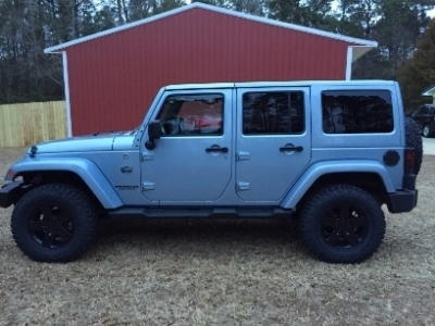

1. Rampage front bumper
2. Smittybuilt rear bumper
3. Pavement Ends Sprint top
4. 2.5" rough country lift
5. Plasti-dip grill
Tires and rims in the next few weeks

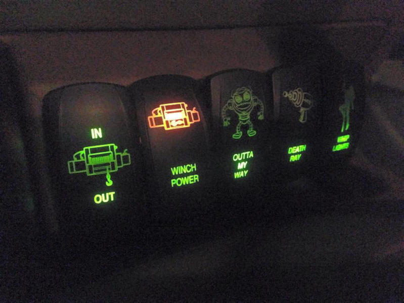

Originally Posted by WWP_JK
Installed a winch rocker switch in the A-Pillar. My winch isn't wireless remote capable and I don't like running the remote through the window. $18 for the switch on eBay and a few hours to wire it up. The bulk of which was heat shrinking all the wiring.
I hope you got momentary. It would suck to hit that switch by accident. I did a similar in-cab control, only I added a winch power ON/OFF switch tied into the IN/OUT so there's little chance of accidentally engaging the winch when I don't want to.
Attachment 599284
Yeah, it's momentary. I thought about that when I was looking for a switch. The worst that would happen is I bump it and it tightens or loosens just a hair. I only plan to add one other switch to that panel for some windshield mounted lights and I'll put it in the bottom hole.
