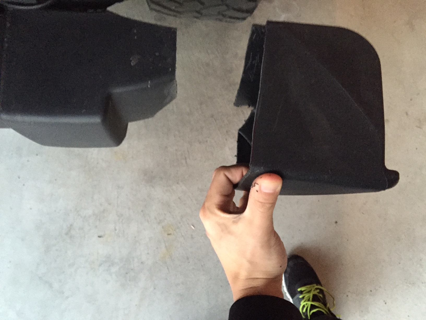

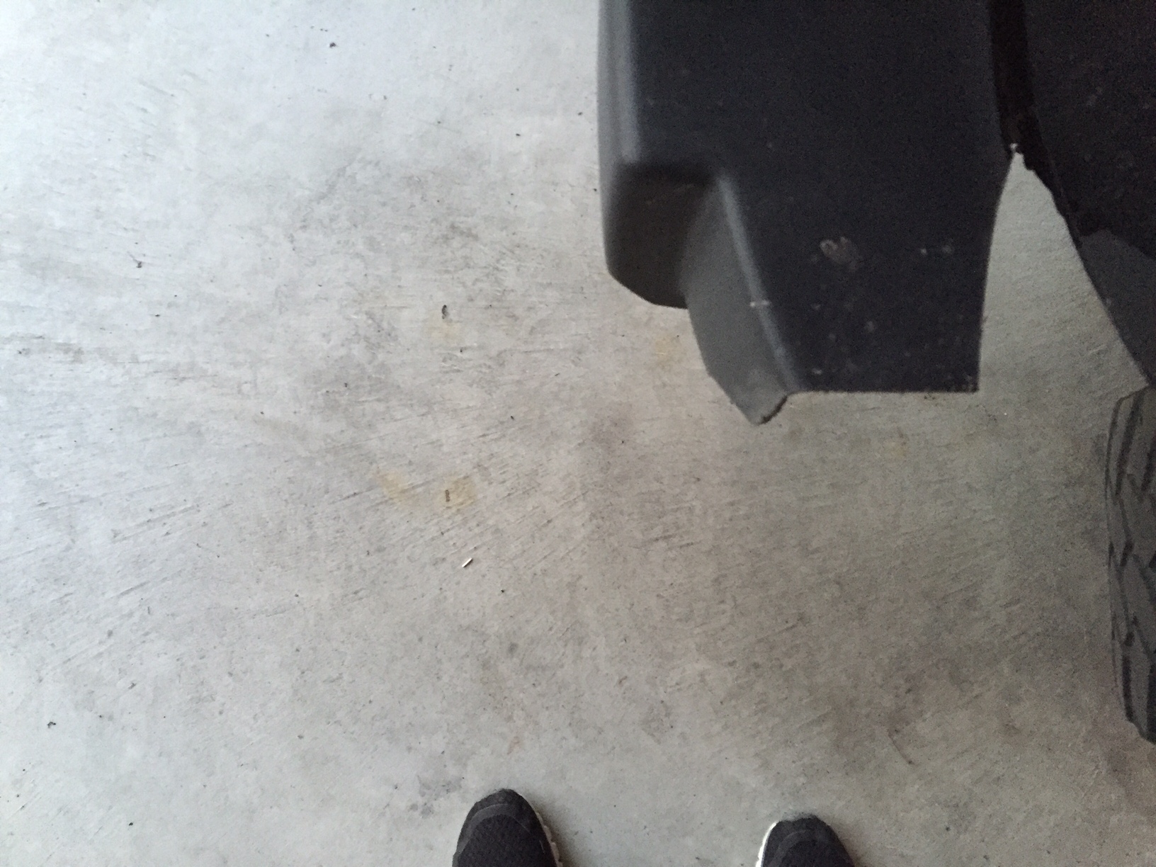

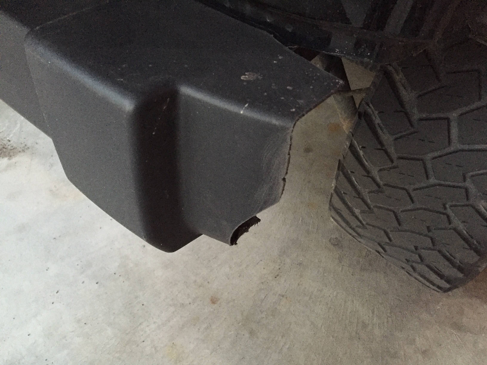

As promised. Since I only dry fitted these I could take them off. You can see the trimming of the bumper that will be hidden, and the size of the end cap that slides over it. The one thing I wish I thought of at the time would be to make sure the inside part of the bumper (which faces the body) has enough plastic left so when the end cap is on it will still be closed off to the elements. I haven't looked yet but if I took off too much on the inside, I am going to have a gap which I would assume will get filled with water etc with no mudflaps. If that's the case I will add some back on the inside to cover the gap.
Only other thing I can think of is to be careful on how much you trim bumper so end cap has something decent to mount to. I plan on using the epoxy, and then 5 plastic push pieces each side (2 on top, 2 on fascia, one on bottom). Need to sand them a bit to straighten also.

Nice! I like this idea. Like to see final out come, but I think I will start this project this weekend

the hard part was done - haha. priority this Saturday to wrap it up - at this point im hoping its as easy as mounting the stubby caps from the front.

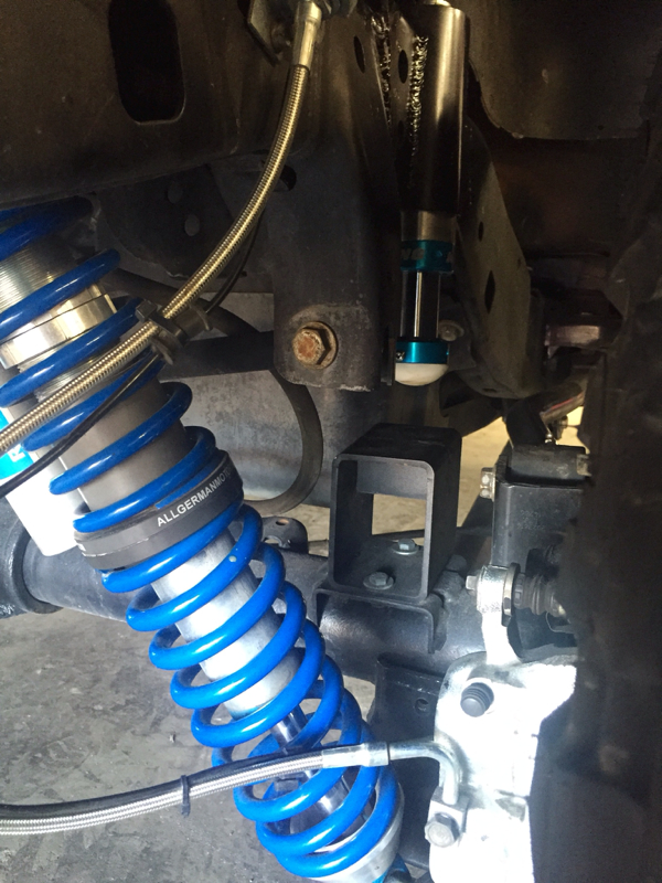

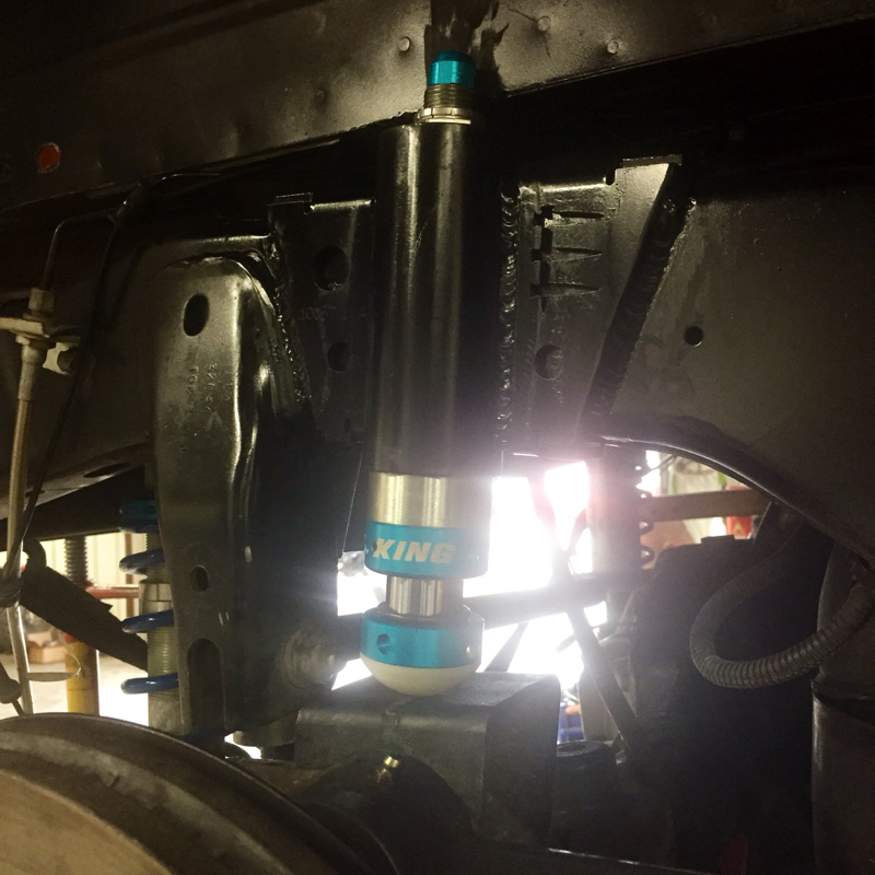

Rear air bumps installed
