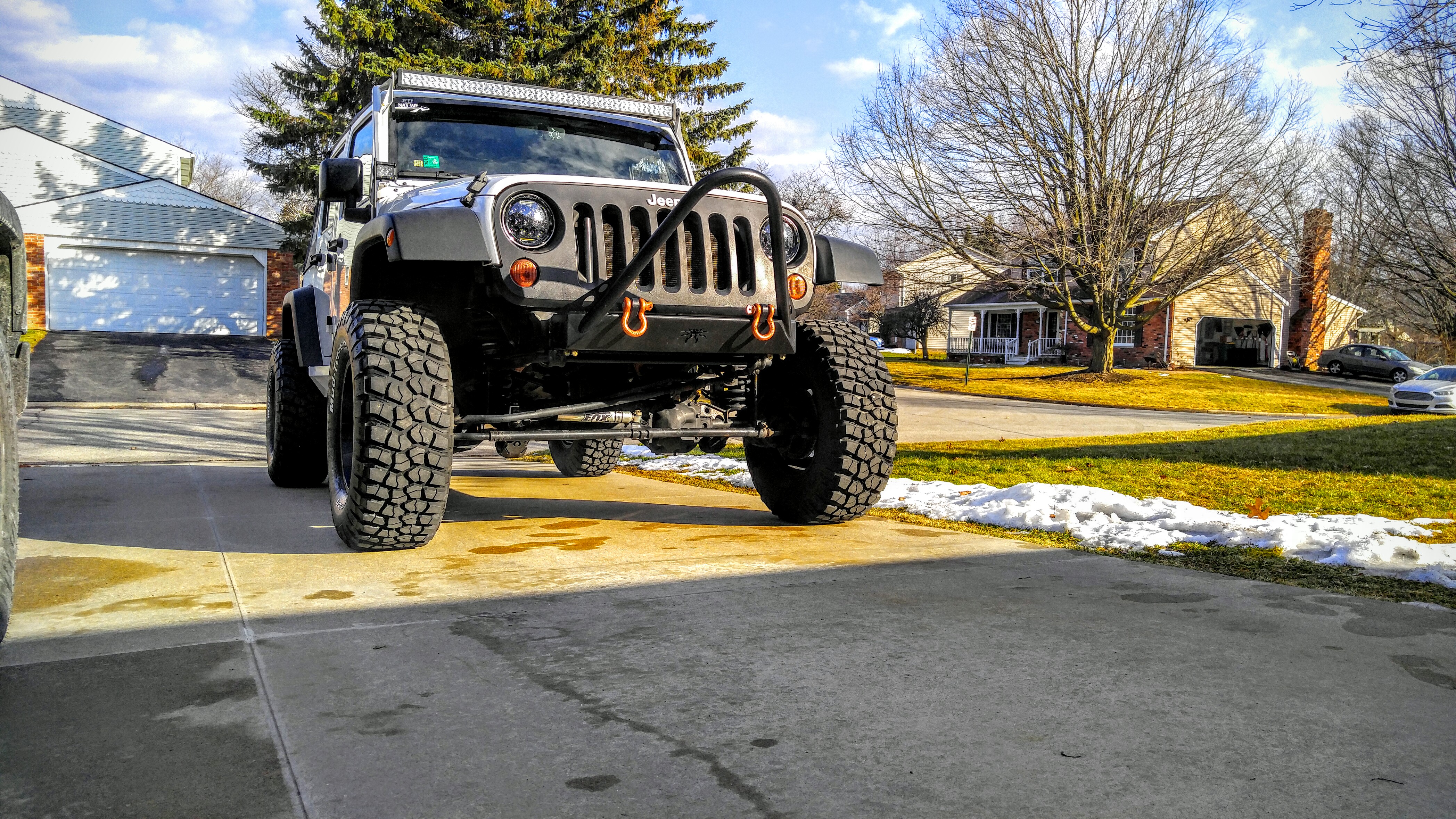

Got a lot done to the jeep this weekend actually. Given that I was so busy being my birthday and all, I'm surprised I found time for anything really.
New headlights, grille insert (not pictured), and 1 ton drag link (not pictured). Install of the lights and grille went smooth as expected, but damn that drag link was a pain. Still needs adjusting, but just getting it bolted up and road worthy took long enough. I'll probably end up just paying for a front end alignment and save myself the headache lol.

Where did you get the 1 ton drag link? I'll be needing to address my tie rod soon.

I'll pm you this same information in case what I say violates vendor rules or something.
But I built my drag link using RuffStuff 1 ton tie rod ends and 7075 aluminum tubing from Wide Open Designs. For the drag link you will need an offset end for the knuckle side and a standard end for the pitman arm. The tubing has both left and right hand threads.
You can do the same with the tie rod, but for the tie rod, you'll need both driver and passenger offset ends. Tube is threaded also has left and right threads.
For an even easier process I would just go to Fusion4x4 and pick up their 1 ton tie rod, same thing and a price you can't beat. If you really want to step your game up, they offer 2.5 ton steering for not much more.

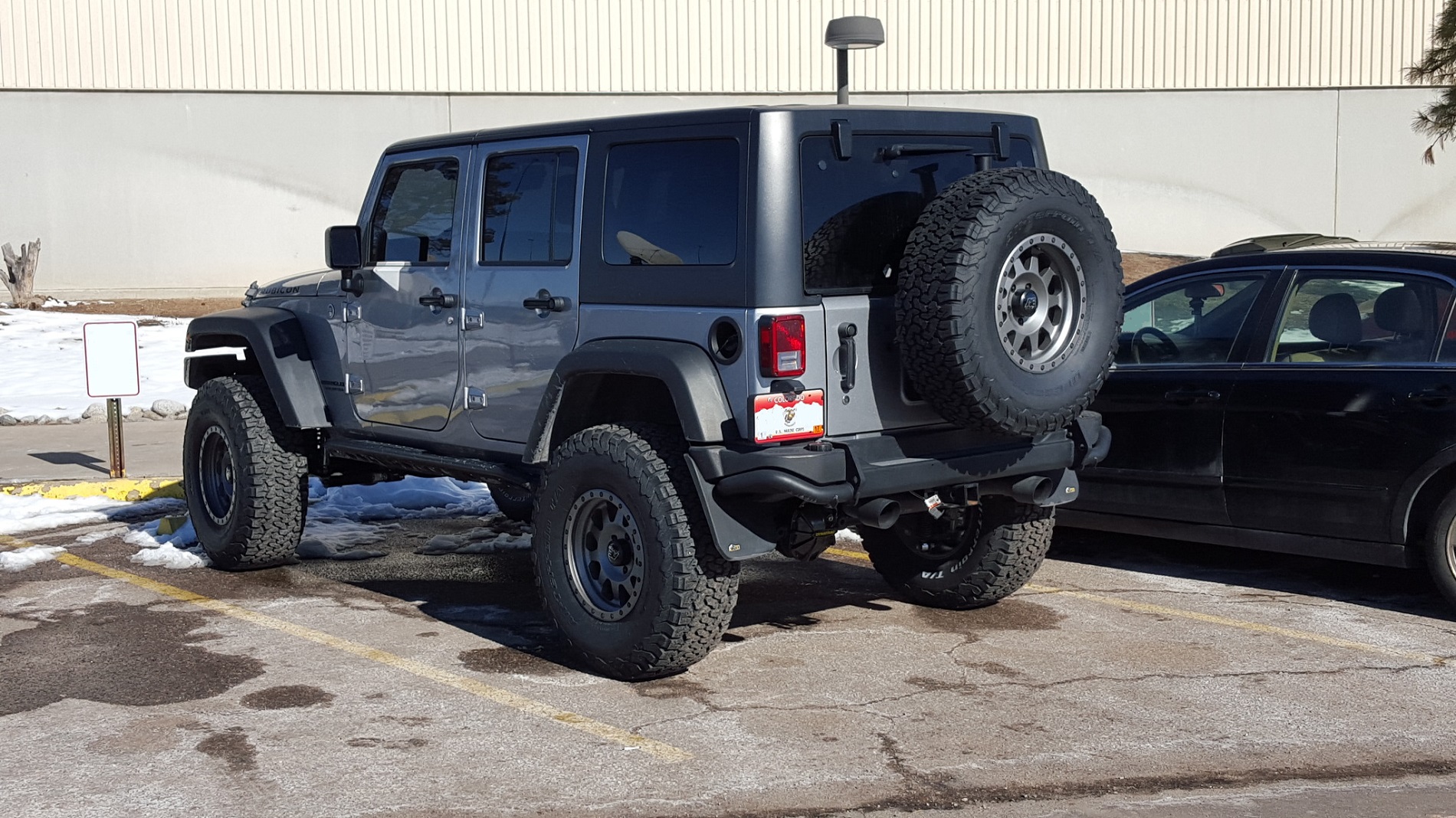

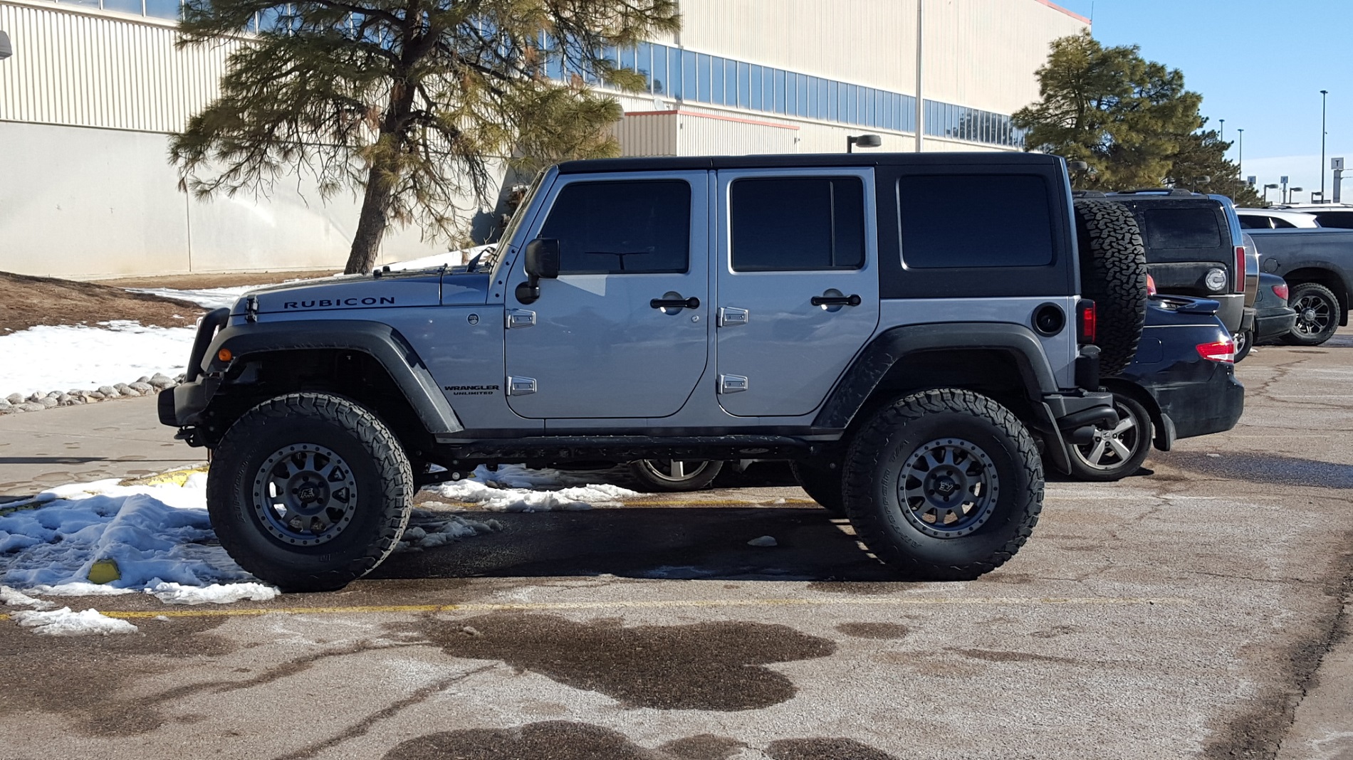

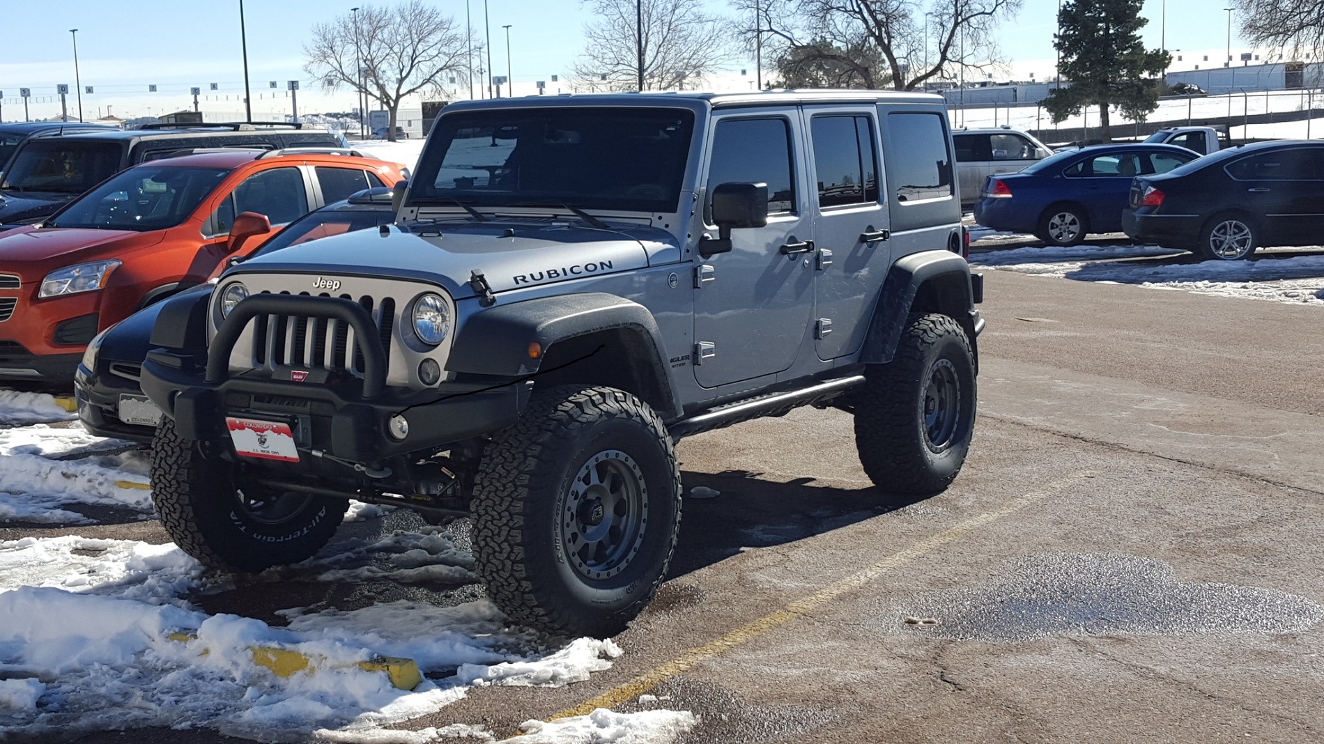

Added Superchips flashpaq this week...
Feels like I dropped a V8 in it!
4.5" AEV DS/SC Lift
17" American Eagle Graphite 012's with 37x12.50x17 BFG KO2's (5)
Dynatrac Prorock 44 front axle housing with HD Ball Joints (reused stock axles/locker)
Dana 44 JK Rubicon 32 Spline Placer Gold Rear Chromoly Axle Kit
G2 Axle & Gear Ring & Pinion Set - Front/Rear 4.88
AEV JK Premium Front Bumper with front skid
Warn xd9000i Winch with roller fairlead
AEV JK Rear Bumper with Tire Carrier (and water kit)
AEV Rear Bumper Water Tanks
AEV JK Hi-Lift / Pull-Pal Mount
Dynatrac Rear Differential Cover
LOD Rock Sliders
48" Hi-Lift
JK Fuel Tank Skid
Cobra 75WXST with external speaker - 3' Firestik (quick disconnect & HD Spring)
BOLT Hood Lock
Superchips flashpaq - 91 octane
