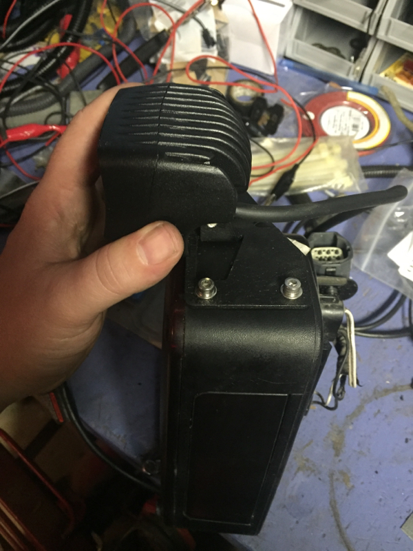

thanks! I had the hardest time finding anything showing how others had wired theirs. I didn't think to take any pics myself. I grounded both lights to the body behind the tail lights then I ran a single power wire down and out the bottom of the drivers side cavity with wire loom over to the passenger side and connected it and another power lead to the light and then ran that all the way back up to the engine bay and connected it to my onxybox. Everything is covered in wire loom. If you pull your tail lights off or look from under neath you will see that there are just foam inserts set in place. And is very easy to pass around. Hope this helps!
Ok thanks bud. Did u drill a hole on top of your tail light to run the wire?

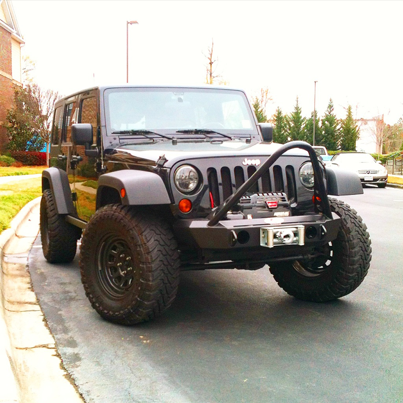

Installed an LOD shorty stinger bumper and powerplant

yes I did. Technically 4. Three small holes hold the mounting bracket in place and then I notched the back for the wire. Here's a pic showing the mount a little better. I had not yet notched it for the wire. But you can see where it would be if you look closely under the wire.

Gotcha. Thanks for the pic.
