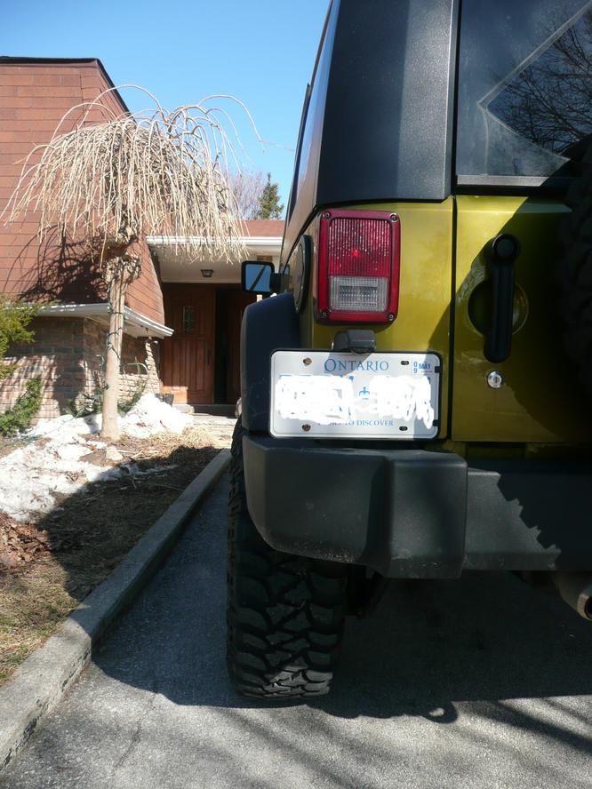

here are a couple of pics of what 285/75/16 tires on 16x8, 5 inch backspaced wheels look like.

actually, the pic of the rear wheel is more accurate as the rear axle is centered due to the track bar relocation bracket that came with the lift kit.
the front axle shifted just a bit and the side the pic is of is the side that the wheel sticks out a bit more on than the other side.
hope that makes sense.

That looks good Hbomb....I think I could get away with that
I don't suppose you have any side shots that show your wheels ?
