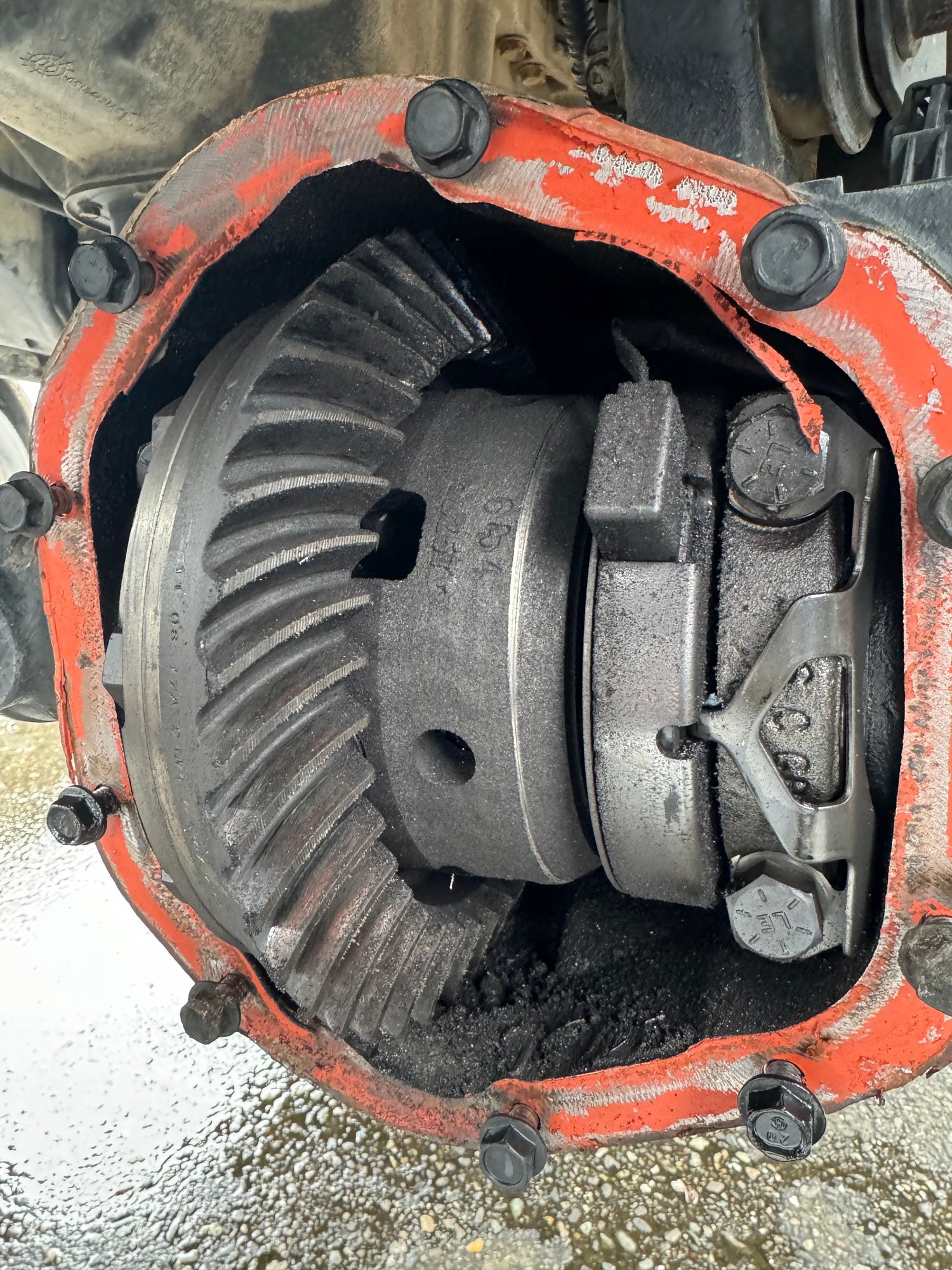

These are the pictures I was able to take when I visited the shop yesterday. I'm not quite sure how to tag people/reply to the comments with images so I hope this helps in showing what exactly I'm dealing with. That's a pile of metal shavings, not dirt or anything.

So you have a D44, probably 4.10 gears (3.73 were possible depending on year/transmission)...I'm not one who can look at that and really tell anything about the internals as I'm sure some of the more experience members can, but I would agree that to me that pile of shavings does look like its run dry.
That said I would still RUN from any shop that told me it was going to cost $13k to fix/replace...if it were me personally, I would look to find a matching rubicon front axle assembly (https://www.autopartsearch.com/ you can find the exact model with matching gears) tow/limp it home, and bolt in the salvage axle in my garage...If you're not up for that then find a local shop who will quote you labor only to R&R a complete front axle assembly, order and have the salvage axle shipped there, drive or tow the jeep to them, and pay them to install it.

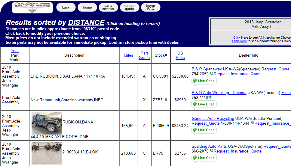

+1 on everything MD_ says above there. The rubi 44 increases cost of repair a bit, but we're still not even sniffing $13k. You're pretty much looking at a full regear and locker replacement at a reputable offroad shop, OR a simple axle swap if you can find one with matching gearset (have to determine the gears ya got there).
Quick search on https://www.car-part.com shows a couple not far from you with 4.10 gearing as an example. You obviously have to know what gearing you have first. Lot of Rubicons started coming with 3.73 from factory. Yours may have been regeared as well so figuring out gearing is step 1 -
