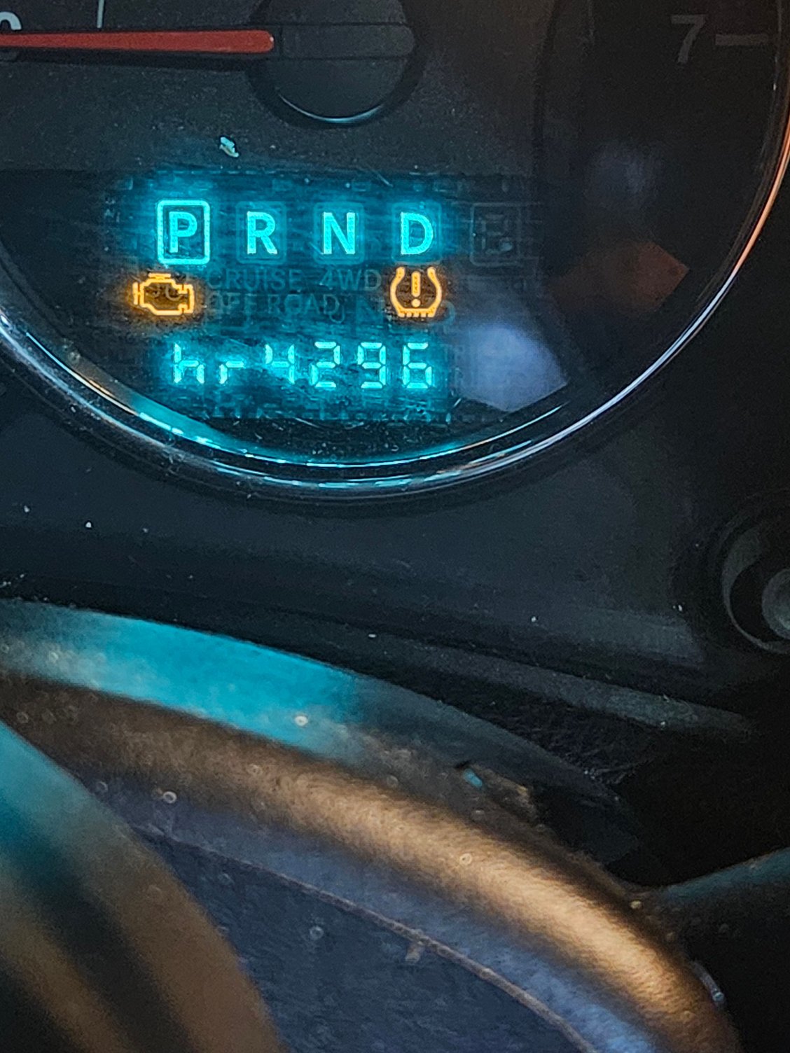

Hello, I have an error code popping up on the console from the " (!)" hr 4296
Can anyone assist? I cannot find what this is.
Error code
Error code
Please see attached picture

Sid you do the key dance to get this? Or, just flipping through the EVIC?

I did the key advance, but nothing would come up, and then I pressed the mileage button and this code came right up. This only comes up after the key advance (I think).
I had no heat and took it to the shop and they cleaned out the lines and said they were clogged up to the heater core. Have heat now.
I still have the (!) Sign, but apparently is due to low tire pressure. I keep filling air in the tires to get it up to 35 psi, but keeps lowering to 30, does not go below. Im assuming theres no leak and its older tires and start of winter.

I'd pop by any auto store and have them scan the codes and get an actual obdii code if there is one. no clue what that is.

That's the hour meter. tells how many hours the engine has been running. Rolls over at 9999
