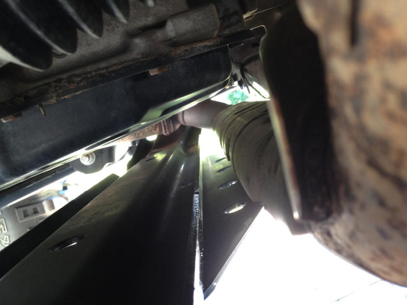

So crap gets caught in between there?
I wonder what the new "bar" looks like

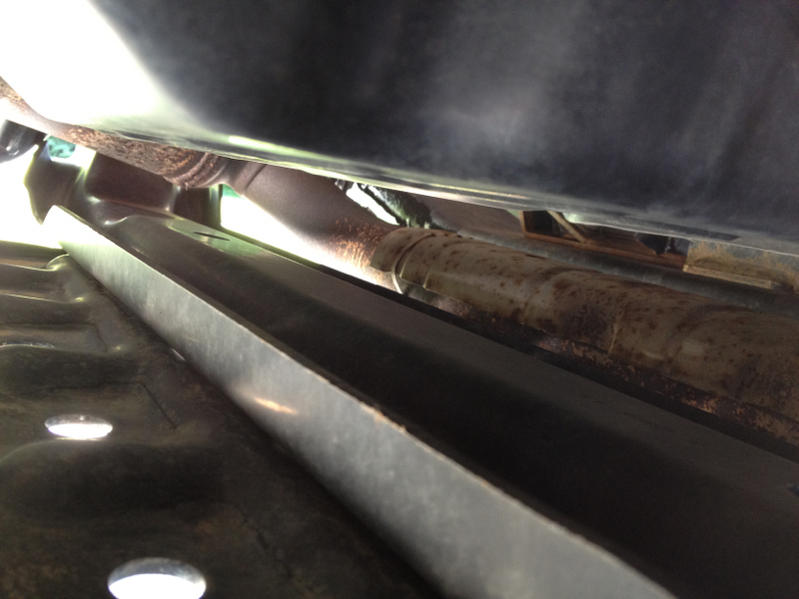

better pic
Take a look at the bottom of a 2011 or 2012 and you will see the skid bar. Much less protection.
Or look here:
https://www.jk-forum.com/forums/stoc...design-166689/
