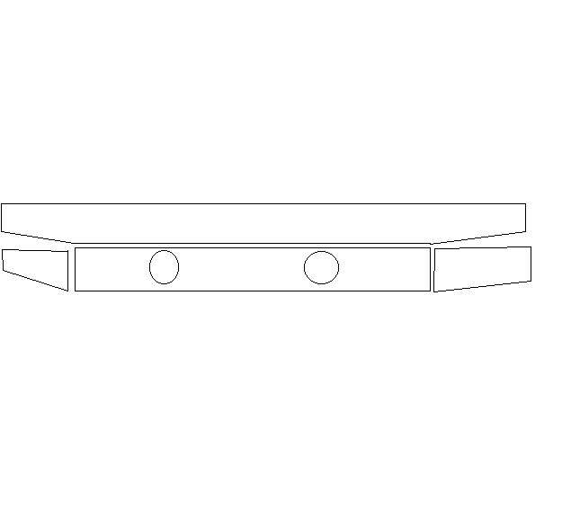

im strongly considering an alum bumper build as well.
Mainly, the thought of adding weight to the jk is just rediculous.
Im surprised no one has done alum yet.
i drew up a simple plan, not sure yet, but basicaly cut alum in these pieces, then weld them together.
