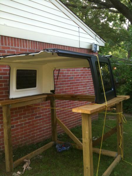

I built this. Got the idea from a member here. Back up to it, slowly pick up and slide it on until it is half way on, get out slide it the rest of the way. Takes longer to take the 8 bolts out than it does to remove the top.

Been thinking about building one of these this weekend. I would love a hoist setup, but unfortunately only have a metal.carport. This rack is about my best option.

Built one myself thanks to your post an the idea from others! Sure does take the stress out of my help dropping it haha.
