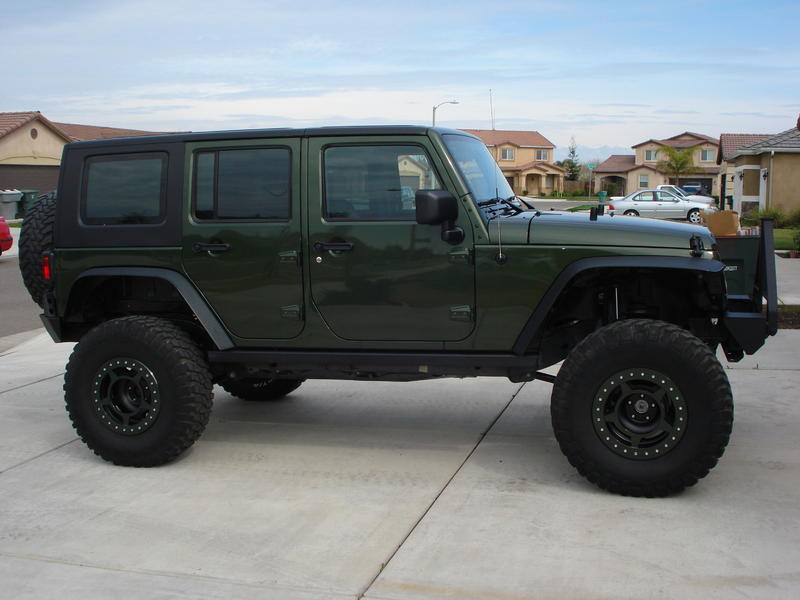

I think beadlocks require thought before purchasing. They are expensive and usually need you to mount and maintain them...

Im running the spyderlock wheels and love them , they are a bit of work,takes time to put twenty some bolts in 5 wheels and torquing them down and you need to keep up on them and make sure they re tight. I love mine cant say enuf about them.
