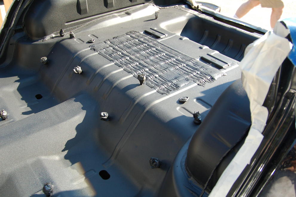

Spraying the liner was not hard at all. The prep work was the most time consuming part of it. The better you do on the prep work, the better your final product turns out. I have one pic on here that I can share. But I will still take some tomorrow with everything back in the Jeep and months after the install.

*Edit* I used the tintable kit and got a dark gray from a paint shop to try and match the interior. Love the way it turned out!

An how did you remove thoat not great looking molding/weld job in the floor that was there to give it a clean look???

Ah, part of the prep work that is a B#$%^!!! I used a mixture of a wire cup brush, dremel, and flat head screw driver. Oh, and water. The top part of that goop is hard. Once you get past that, it is soft if you keep it wet. You can follow this write up and search for others (Raptor Liner)
