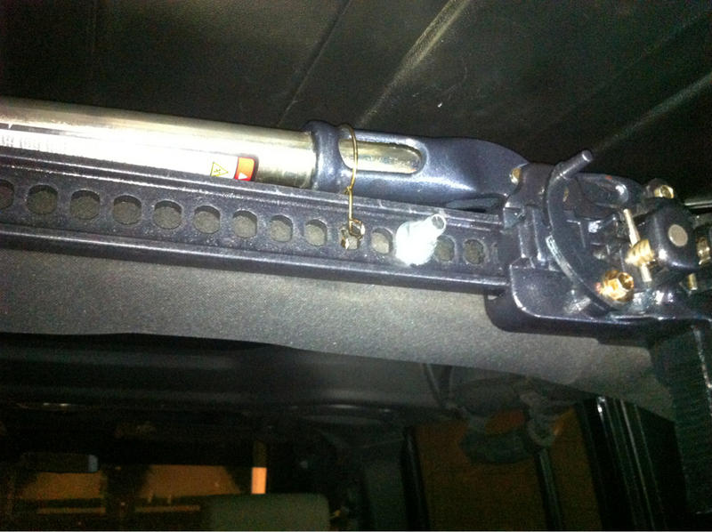

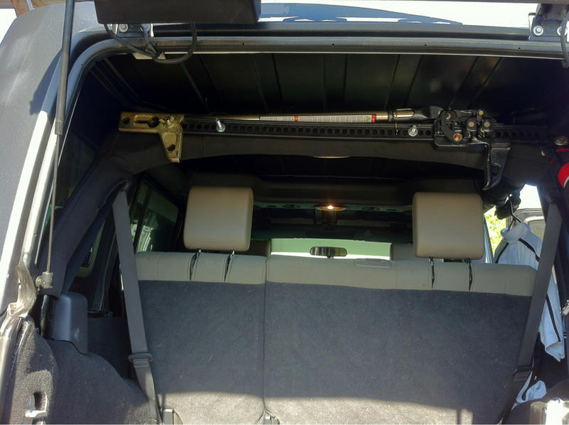

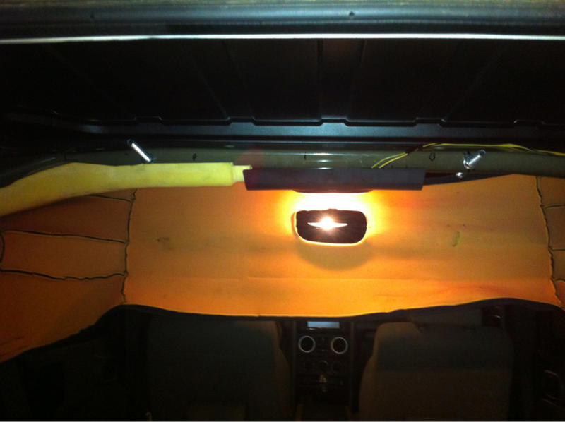

Mounted mine inside to the rear roll bar
Parts from home depot...cost a grand total of $6 and took me about 45min
I drilled two 1/2 holes through the roll bar, installed 5" bolts through the roll bar then bolted it down tight, cut two small holes in the roll bar cover, then mounted the jack. This is a sweet and very sturdy mount, doesn't rattle or come loose, plus it's high enough it's out of the way and easy to remove or replace when you need it
