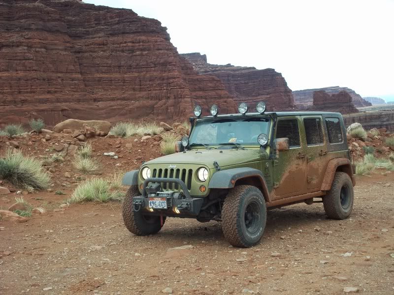

I have 33s and rubbed only when wheeling... all I had to do was put on a Teraflex leveling kit and I've never rubbed again. I didn't use spacers either. If you aren't interested in lifting your Jeep, but want 33s, go that route.
You can see here the front clearance with 33s and stock suspension...
And here, you can see a year later with the small leveling kit from Teraflex and the same tires... just enough room and doesn't rub when wheeling.
