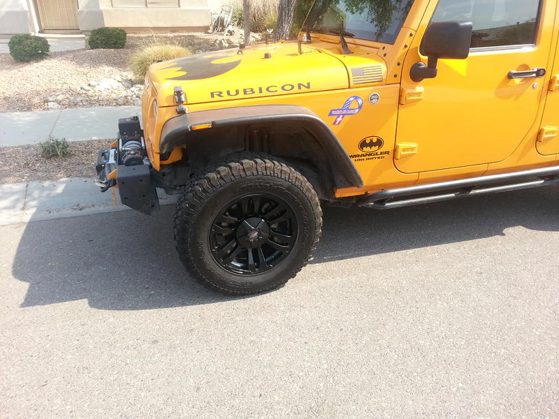

Did you ever get new rims? I am not sure if you were looking at the same rims I have (see pic) but if you're going to do a lift I would advise staying away from them. I bought these rims last year and after doing research I found that lifts require 4.5" backspacing or less on rims... my rims have 5.5" backspacing. So I am already looking at going with some Pro Comps Series 97... they should be here by Friday. Hopefully I'll have a lift in the near future too.

Nope. Factory wheels still. And likely to stay that way.
I was considering the AEV Pintlers in black but I've been trying hard to leave the jeep as stock as possible in any way that could affect ride quality.
Maybe this summer I'll finally go very small lift and some 255/80R17 on factory wheels.
I always lifted and got crazy with all my past Jeeps and regretted it when they became poorer daily drivers.

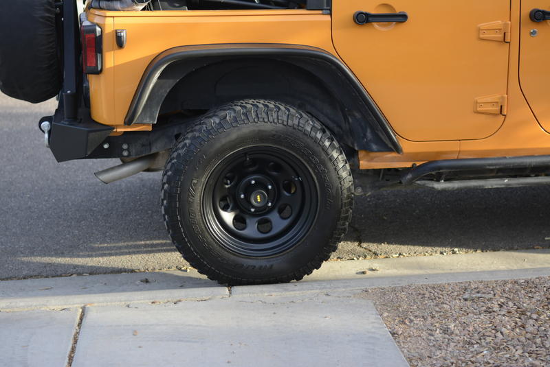

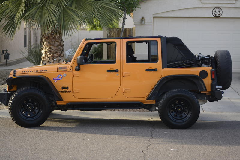

Swapped out to Procomp Series 97 rims in order to get the right backspacing for doing a future lift...
