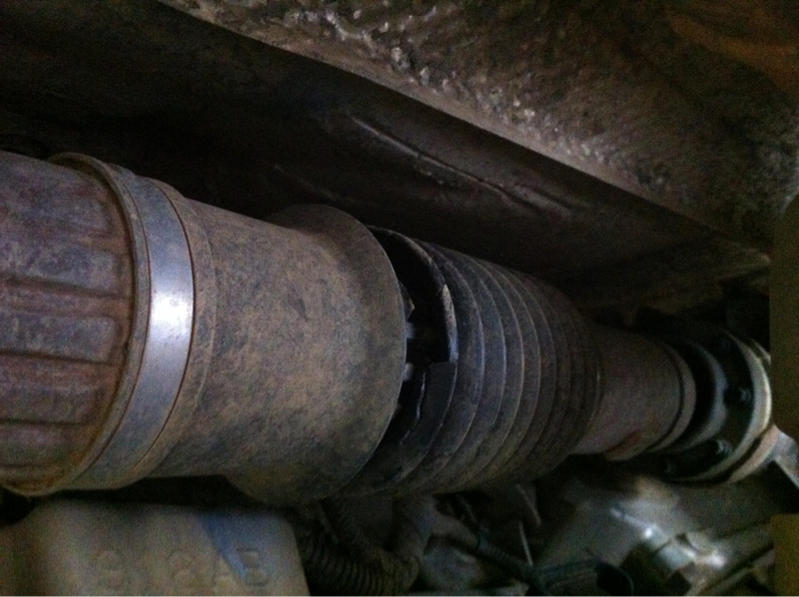

A stick got caught under my jeep and it ripped the slip joint boot as I pulled it out. I'm going to tear the rest if it off; I'm thinking i'll be ok for a while as long throw some grease on the shaft and try to stay out of the deep mud. What do y'all think? The boot is on national back order and I'm going wheeling this weekend.
