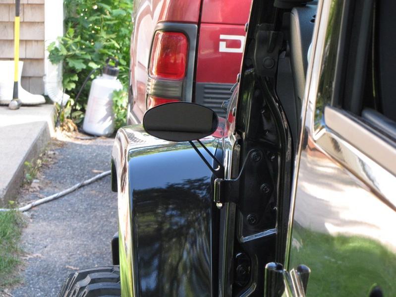

Based on Harley #91910-90A / 91909-90A, similar to the picture in post # 8 in this thread.

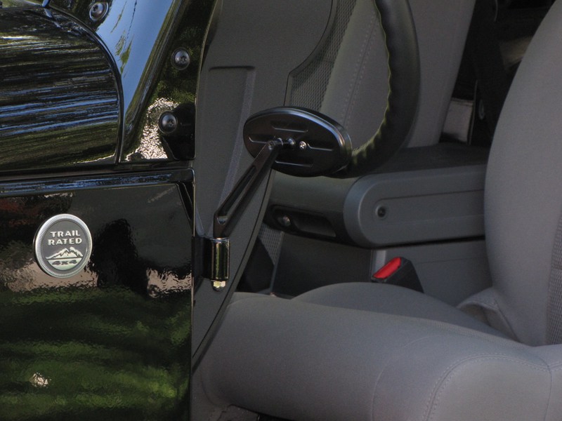

Packed with the mirrors will be a chrome washer, chrome lock washer, 1/2" chrome acorn nut and a black cone washer. On my '10 I use the black cone washer and acorn nut. From various photos on the site it appears the threaded shank on the mirror stem was longer in past production than in current mirror production allowing use of the other washers as well.
Place the cone washer on the mirror stem with the large end up toward the mirror and the smaller narrow end down so it will slide into the top of the hinge. If the mirrors you receive are like mine after the mirror is inserted in the hinge the threads will just barely extend below the hinge. There will not be enough threaded shank below the hinge to fit a conventional nut. I thought I had a bust on my hands until I went ahead and tried the acorn nut. The shank of the nut will slide up into the hinge enough to grab threads and the shoulder of the nut will tighten and hold against the bottom of the hinge. The cone washer will partially draw down into the top of the hinge ensuring a tight assembly.

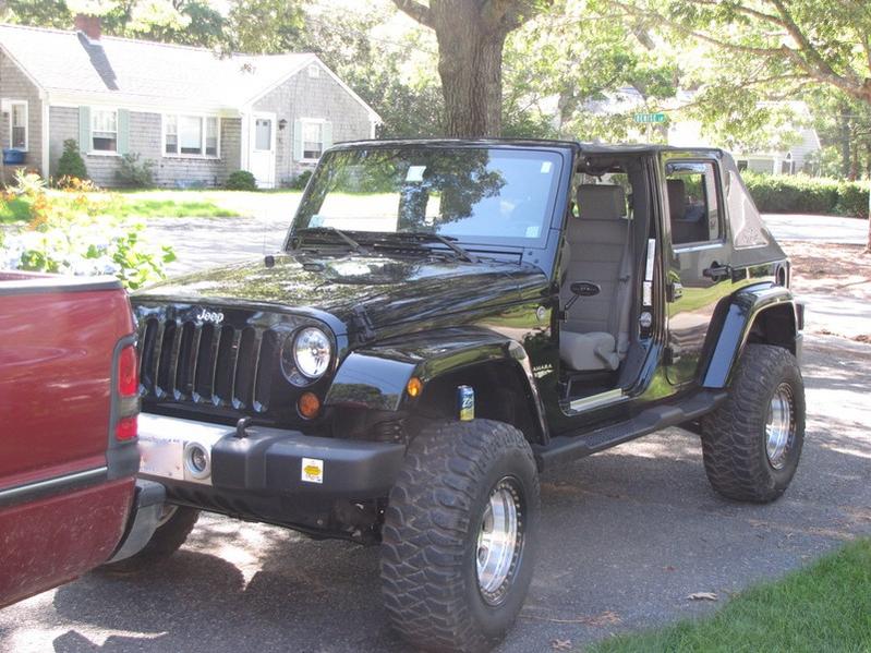

I had read a lot of vibration and movement complaints directed toward some of the other mirror solutions. Curious I have driven the installed HD mirrors into a 20 mph headwind on the interstate at 80 mph with no more vibration than the regular mirrors. Also the mirror stems stayed put. They did not slowly rotate toward the Jeep body rendering the mirrors useless. I took them down a washboard dirt road at 50 and could see to the rear just fine.
You will have full view of the drivers side mirror. if the passenger mirror is installed in the top hinge it will be partially blocked by the bulge in the dash at the AC vent but it is usable and a little head tilt will expose more.
I have tried installing the passenger side in the bottom hinge. I had full view but couldn't seem to get it aimed to my satisfaction. A passengers legs did not block my view of the low mounted mirror. I plan to try this position again. One high mount and one low mount does look a little odd though.
I am pleased with the HD mirrors. To me they are a good balance of price, performance and looks. Looks can be really important when you are picking up your high school freshman son at school.
FWIW Texas only requires a single mirror so the first thing I tried was no side mirrors but I found I was to accustomed to driving like it was a semi, I depended on side mirrors. Went real cheap the second time and tried sticking some 2" spot mirrors on the closed outboard AC vents like I had read about on the forum. The spots did not work well for me. Then I hit this thread talking about the Harley mirrors and I am happy with the result.
